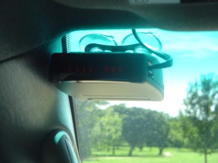

Here is where I have mine because I can not fit it above my mirror.

I did what blue GP did w/ my V1.....I like it there, because it will catch my eye w/ the lights if I have the radio cranked....plus the sunvisor is fully functional, too.
