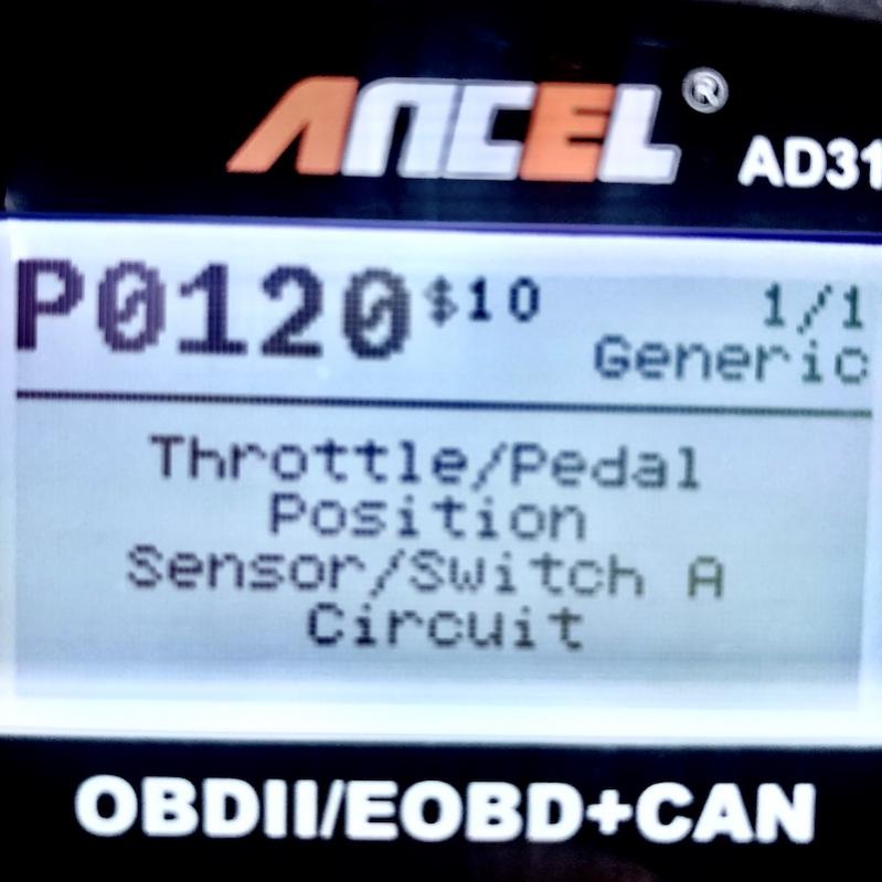

I have an occasional 0770 ("Shift Solenoid") and an increasingly frequent 0120 ("Throttle/Pedal Position Sensor/Switch A Circuit").

Are you sure you have a code reader sending valid codes? I've never heard of a P0120 on a 4Runner. If it is, you don't have a Pedal position sensor (that's for 01-02) so it's most likely the Throttle Body Position Sensor. If you have a multimeter you can check the resistances again the service manual specifications. If not, it's $50 from Toyota.
Yep, my old Ancel reported as shown below and my current Ultra Gauge does the same - every couple of weeks.

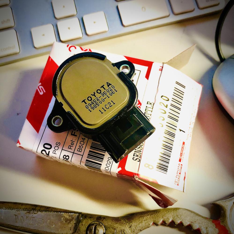

I just dealt with a failing TPS, it will eventually lead to stalling and surging so best to tackle that one sooner than later. Will lead to larger issues.
Thanks - I have moved this to the top of my list (another split CV boot can wait some more). I don't have any noticeable symptoms yet, acceleration is strong and predictable. I'll get one in the next couple of days replace it and check all the wires involved. I don't have a service manual yet but it appears be located on the firewall side of the throttle body intake, right? Mine seems to be labeled Toyota on the silverish flat plate

In the meantime, I'm going to try to resolve my TPS issue with this new sensor....

Just be careful not to strip the bolts. They are on there pretty tight after heat cycling for 20 years.
Thanks - a couple drops of PB Blaster are already doing their magic (hopefully). Gonna give it a couple days. I couldn't really see the heads - are they screw-heads?
Edit - JIS 2 driver ordered. About time I stopped trying to use Philips on a Japanese vehicle.
