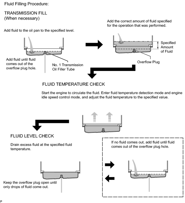

cmills, check your transmission fluid level (see manual for procedure) and make sure the dipstick reads full or even a slight bit above full.
These A750 transmissions don't have a dipstick.You add fluid til it comes out the overflow plug hole.
