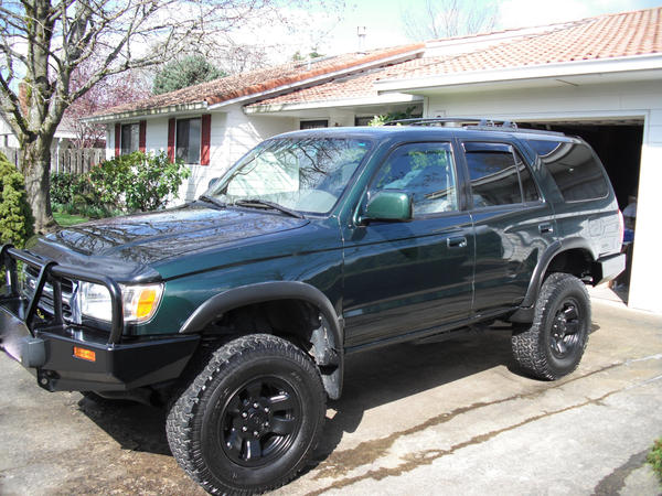

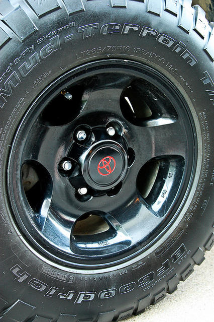

here are mine, they are p.c.'d though. right after a detail so not showing any road grime but i think they look good. i rattle can'd the center caps, here they are a little shinier then the wheels but with a little road dirt on them they blend pretty good.

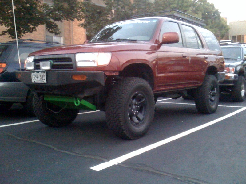

Looks like alot of the sunfire red runners are rocking the black oem wheels

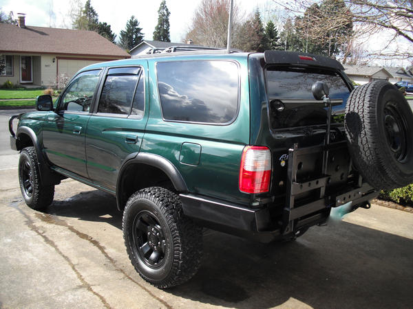

here's mine...was, then i sold it
i used a quick dry flat black paint as my primer and black metallic paint by krylon @ home depot

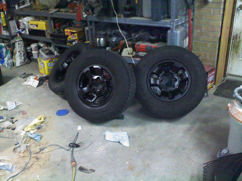

I used a coarse wire brush attachment for my drill and sanded the clear coat off and took it down to bare metal. I then applied Rust-oleum Self Etching Primer. After the primer dried I applied Rust-oleum High Performance Enamel.
For the center caps I hand sanded them with 150 grit sand paper then used Krylon automotive primer and then rust-oleum High Performance Enamel.
Since I painted them at the end of summer I've gone thru some deep mud with debris rubbing the rims with no paint chipping or scuffing. I'm pretty impressed with the outcome.
