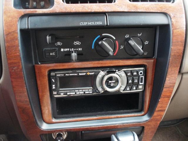

Has anyone removed or attempted to remove this awful fake wood trim?
Opi
Mine kind of started coming off on the top right of the radio/vent surround, and im wondering if its relatively easy to do because I would much rather just have black plastic than crappy fake wood that looks bad and comes off.
It's actually real wood trim if it id from Toyota. Get a heat gun and peel it off. You might have to sand the glue off and plastidip the console if it looks bad.
yep. i had the fake wood and i removed it all. get yourself some 3M adhesive remover and a putty knife. as mentioned, a heat gun should also make it easier. expect to get a couple scratches. the scratches were well worth in though IMO
The trick to getting it off is heat. In the summer, all you have to do is roll your windows up for about an hour while parked in the sun. Since It's now winter, you can roll up your windows and turn your heat up all the way and wait about an hour. In either case, a hair dryer helps a lot too while you are pulling it off.
Use a good pair of pliers and start pulling at one end while keeping the hair dryer pointed at that spot. It should start to slowly peel off as you pull with the pliers. Take your time and don't rush it. Don't worry about the glue residue until you are all done pulling off the fake wood. The glue will come off with either WD-40 or baby oil on a rag. DO NOT SAND!!!
Only the Limited models have real wood trim usually. Most of the time it's a semi-flexible vinyl type of material. The black under it looks way better.

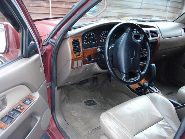

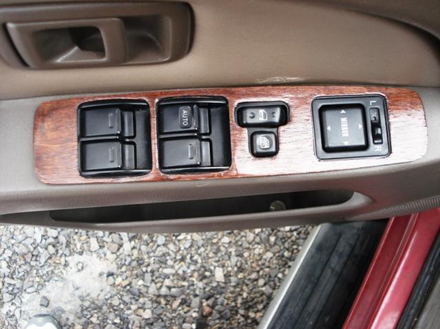

Like TheDurk, I went after the delaminating wood. It took a long time and I scratched the living daylights out of my console; I couldn't NOT put the trim back on with all the damaged I caused.
In the end, I think it ended up looking better than the delaminating wood. I'm terrible with my hands and even with all the scarring I'm glad I did it.
Interior:
Close up (note the spot on the door I melted):
Close up of the only piece of trim I didn't take off (it wasn't delaminating and I didn't think I could get it off without destroying the head unit) next to the refinished wood:
It took me probably about 8 hours to get everything off, stripped of glue, and sanded. The stain/poly process is days long. The adhesive I used is coming up in a few places, I'd like to find something better.

I went back and tried again with my heat gun and some Goo b Gon and it worked wonders. I only did the middle HVAC/radio piece for now.
This will give you an idea of the before:
After:
Damage:
