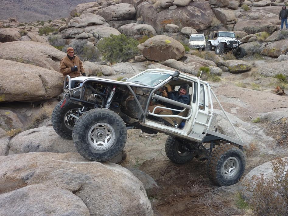

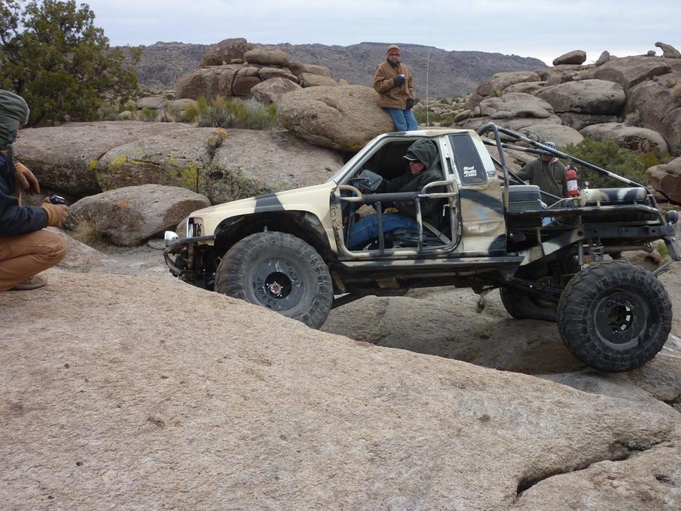

This is how a buddy of mine did his mini-truck. Fine for trail use, but I wouldn't want to daily drive it. Me? I just let the trail do the body work for me.
Yeah those are not intended for much more than tree limbs. And they are NOT welded to either the bumper or the sliders in the ARB format.
Yeah if you were really interested they would be very easy for a guy to make with a bender like mentioned above. Could even make em with some sorta clamp so you could remove them if desired. I think the arb ones are clamp on or something to that effect. Like iballengineer said i dont believe they are welded...
