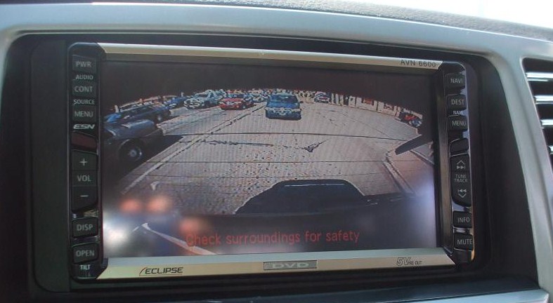

This is how I mounted mine inside the cargo roof for now...thinking of mounting it on the License plate frame or somewhere back there like Darkie's..but I really dunno if I want to drill a hole and go through that hassle. I can see very well with it on the insde and through the window..see pics.

Pretty sneaky place for a camera. I like that mounting location, maybe even a little better than the one I have on the license plate frame. I'll leave mine for now, until something happens to it, then I may re-think it. I wasn't sure if I would even use a backup camera, but I've since used it several times, and it works like a charm.
