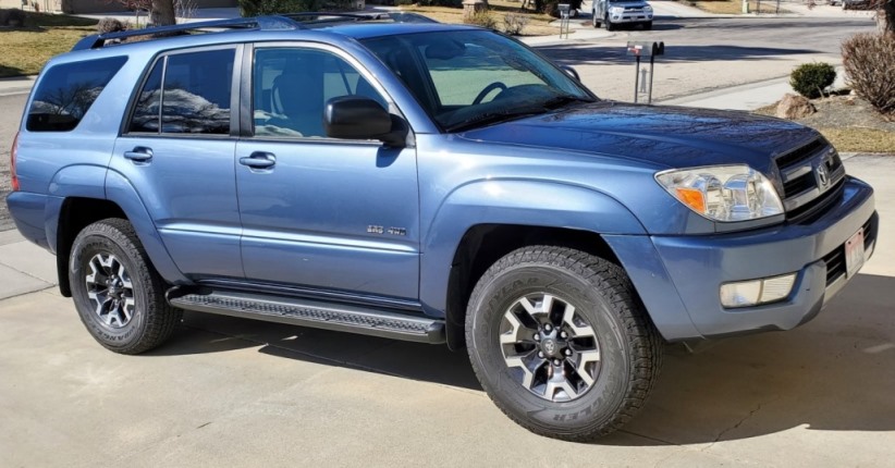

Thanks for all the great responses guys. I found a set of take-offs from a 21' Tacoma TRD Offroad - 265/70R16, which is the exact tire size I have now. Even though I have 16" wheels, I'm still a little rattled by something I found online-
"TRD Pro wheels are available in 2 sizes: 16" diameter and 17" diameter. Both of these TRD Pro wheels are 7" wide. The 16" TRD Pro wheels are made specifically for Tacomas, and the 17" TRD Pro wheels are made specifically for 4Runners and FJ Cruisers"
The offset is ET13 (assuming I did my homework correctly) so it seems like they should work. Any obvious flaws in my logic? :)
Just to clarify, I believe that the distinction of the 16" rims being only for the Tacomas is due to the fact that all 5th gen 4runners require 17" rims, and they're not including us guys with the old sr5 4th gens. I would be really confident that those 16" TRD pros would be fine for you.
My 4th gen Limited (bought used) came with 17” rims, but the smaller brakes so I can also use 16” rims. I have one set of 16” rims and tires (265/75r16), and they fit great. My rims are not OEM Toyota, but close. They are Prime wheels, and were a port installed option for the “Southeast Edition” or the “Texas Edition” 4Runner. I bought the wheels used.
The wheels in my signature photo are 17”.
The verdict is in... Perfect fit! :party:
