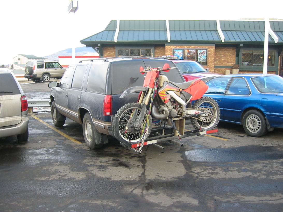

Since getting rid of my truck in favor of my 4runner I was wondering if anyone has used a hitch mounted motorcycle carrier on the back of their runner? I have 8 wrap LC coils in the rear and 882's up front. How much will rear sag with it on?
Just trying to get away from using my trailer. Trying to be self contained
I had an 97 yukon I used one on but it obviously is a beefier vehicle.
Thanks

i built one of these from scrap iron, it weights about 80-90 lbs and my bike is a 98 xr 400, 4-stroke (heavy bike) on stock suspension. i have driven about 150-200 miles a stretch with no problems and very little sag, so i would imagine that with the lc coils you should be better then good.
Good deal. Thanks for the info. It will way better without a trailer for just one bike. The cr doesnt weigh too much. I'm ready for the snow to be gone!

I use a moto tote on the back of my 96 T4r. I added some Firestone airbags to the stock rear coils. There were around $100.00 I think, and a pretty easy install. I pump them up pretty high and the T4r only sags a little with the moto tote and my 06 KTM 450 exc (about 260 lb bike). It sagged MUCH more without the airbags.

Thanks for the responses guys. I do have a trailer when I am pulling more than one bike or my street bike but I want to use it for my cr250 when head to the black hills by myself. I have LC coils in the rear so I might load it up and give it a test run for twenty miles and see how it goes.
You should have no problems with a 250
