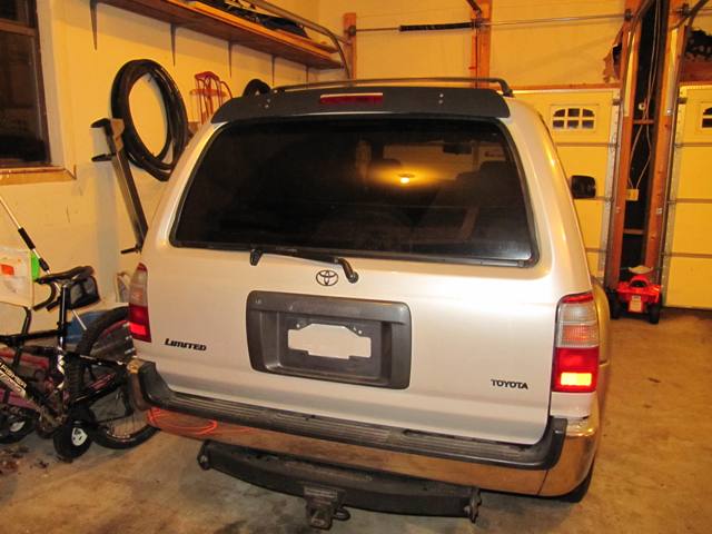

Original Gold Badge Hatch

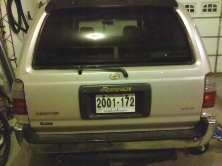

Hatch With Painted Badges

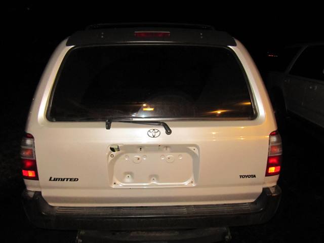

Hatch With Surround Removed

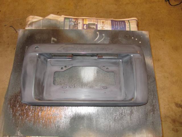

Surround Sanded and Ready for Primer

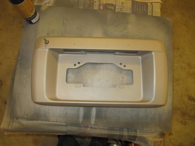

Surround With Base Coat Applied

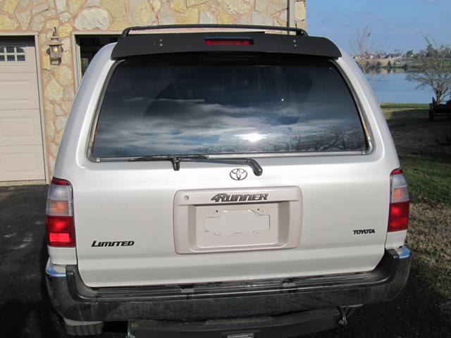

Completed Hatch Make Over
I'm very happy with the results, however, the color matched paint does not match. It is close but not exact. I still think it looks good. I also got a bit of orange peel affect with the clear coat. I suspect it might have been a little too humid. Great mod and well worth the time. It looks much cleaner.
