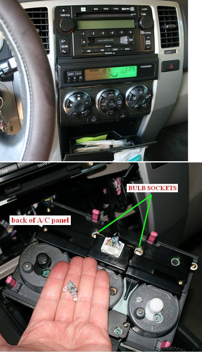

Started my truck today and saw this...
i'm hoping it's just a bulb...
anyone had this problem? if it is a bulb can anyone tell me the part number?
and lastly....how do i change it? :)
I had that happen when I had to park the truck outside. It only happened once when it was really cold outside..for Florida:) My display issue went away as the truck heated up. I know when people do the LED swap, the bulbs are actually soldered in. I could be mistaken though.
Super easy change. I had to change those lights before. The lights just pop out the back. I'll see if I can find the part #s and the instructions to get to the bulbs.
While you have it apart I would just change both bulbs. When I did it I only replaced the one that was out and then a week later the other side went out. The bulbs are cheap so I'd do both.
