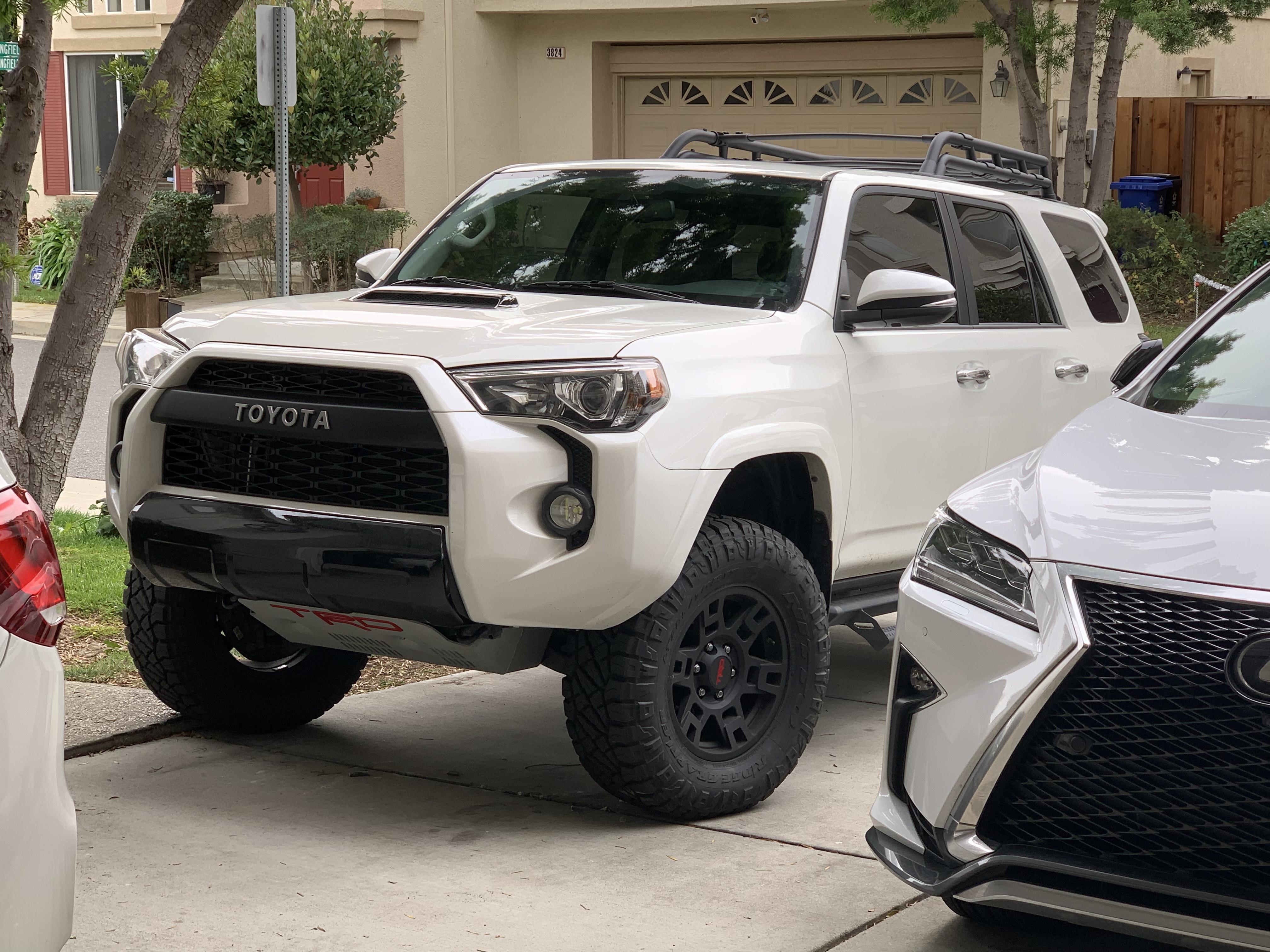

I wanted the looks of the pro but the creature features of the limited since my 4th gen was a limited. I opted for a used limited, stripped out the xreas and modded it to look like a pro [emoji2957]
Now I got the best of both worlds until the 6th gen comes out.

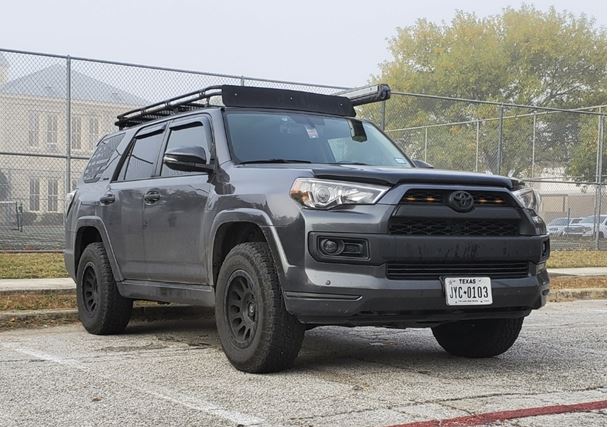

I replaced Xreas myself using Bilstein's and it wasn't difficult at all. I didn't bother reusing the top hat or springs in the front so the install was relatively fast since I didn't have to swap over parts. The Xreas fights you a little with all the lines and fluid so I just cut everything off and cleaned up the mess. Wasn't planning on saving any of it.
For what its worth, I love the Limited and all of it's features. We use it off road and it's just as capable for what we do. I got stuck once but had nothing to do with the vehicle and more to do with my stupidity trying to follow someone I shouldn't have been following!
I drove mine stock for close to 30K miles before I started modding and it's been close to 40K miles with my current set up. I still love it... +1 for the cooled seats too!
Agreed with getting the warranty as well. I didn't buy an extended warranty on mine, but got it certified pre-owned. The CPO covered bumped to bumper for 50k miles from purchase. My XREAS started leaking very little around 70k miles. Had it replaced free of charge (the receipt showed upwards of 4k for replacement). Haven't had any issues with it at all, and I'm right under 100k on the odometer now. Once the XREAS starts leaking, I'm going Bilstein.
