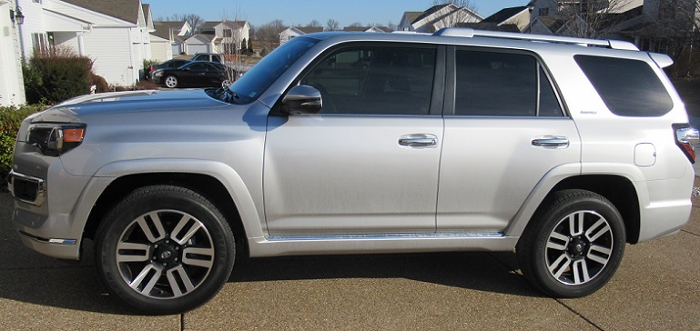

Did it! Thanks for all the replies and insight/advice. LOVE the Limited!
Love the leather (ventilated and heated).
Love the key (no need to take it out of your pocket).
Love the full-time 4wd.
Love memory seats.
Don't really like 20" rims (changeable).
Sunroof cuts into headroom a little.
