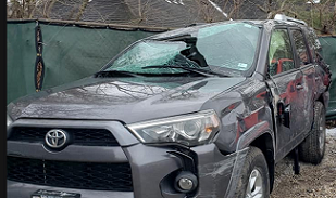

My wife's cousin had an SR5. They were in 2wd hit some black ice on the interstate (going ~50mph) and had a horrible crash. She said she had zero time to react and the truck was "instantly sideways." The truck hit the median, rolled twice, and landed on the road with cars coming at them. They were ok, just bumps and bruises, but the 4runner was totaled. VERY scary.
That got me thinking, what if she was in a limited with full-time 4wd? I realize it is impossible to know the answer, but I bet she would have been better off in the limited. Maybe she wouldn't have slipped at all.
I know the limited is more expensive, (and trust me, i definitely don't want to spend more money on a vehicle) but if the limited could save a crash, OR A LIFE, then that extra couple thousand dollars is nothing.
Am I wrong?

Heres a pic.

Heres a pic.

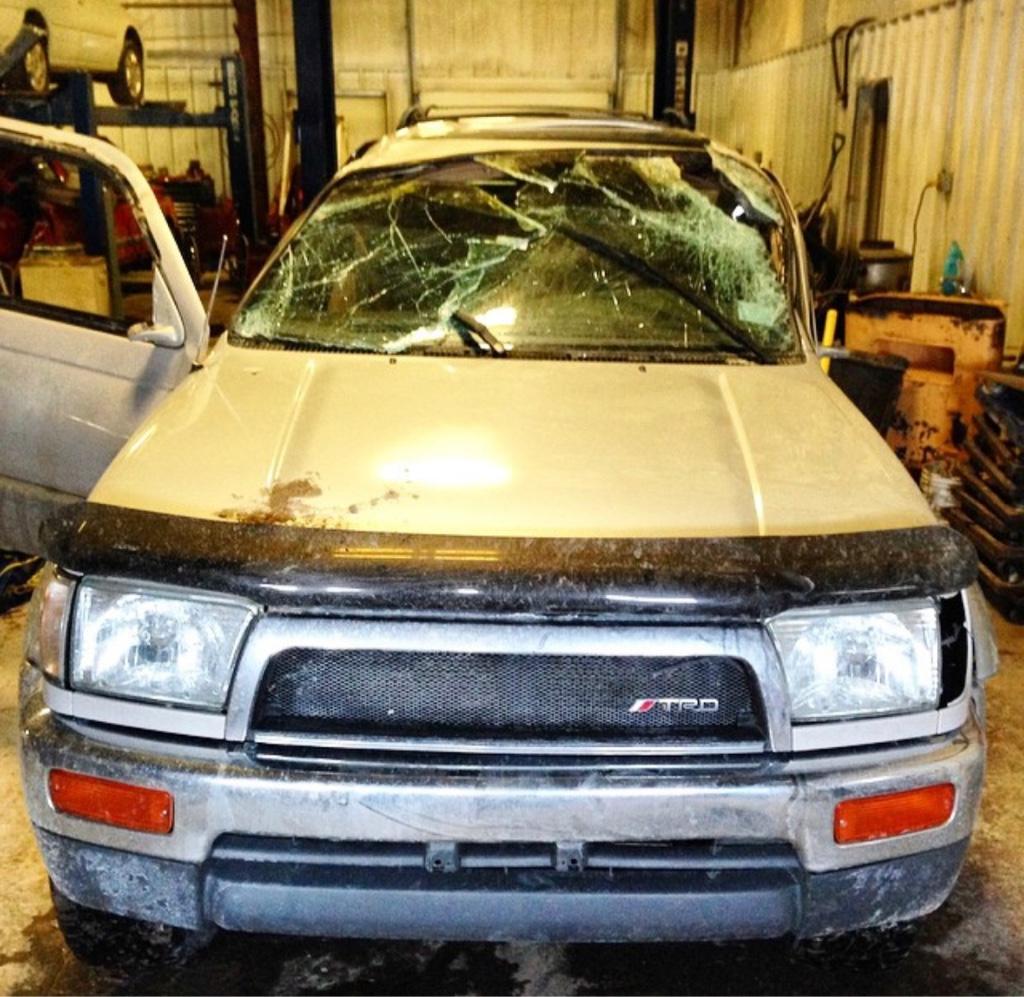

Same thing happened to me in my first 3rd gen, backend went right out with zero time to react. Rolled it twice, me and three friends walked away without a scratch. Have only owned 4runner since.
Glad to hear everyone was alright! Do you think the wreck would have been avoided if you had full-time 4wd?
Yes absolutely. Loving the fact my Limited has full time 4wd. Have had zero issues, and haa held its own off-road.
