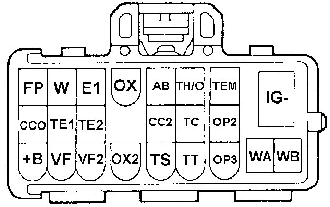

I don't know how it works on 3rd gens, but I know on MK3 Supras you can jump 2 pins in the diagnostic box and it will turn the fuel pump on. If you can figure out how to turn the fuel pump on and let it run for a little bit before starting the truck and it starts up normal then your problem is the check valve.
So I think you should be able to jump the pins labeled FP and B+ to get power to the pump. Do this for 30 seconds or so and then try to start it. If it starts just fine it's most likely a bad check valve in your fuel pump that isn't holding pressure like it's supposed to when the motor gets heat soaked.
