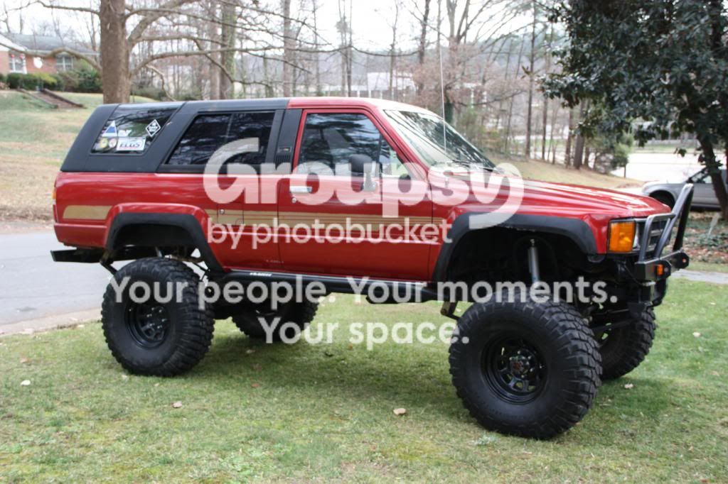

So it's time to finally try and document this stuff and give you some eye candy every now and then. Here's some pictures of her, currently waiting on my front diff from ECGS, blew a spartan locker, hoping to get it all back together by May.
Need to get some updated pics, currently locked F/R, dirty 30's, ARP studs, duals (2.28x4.7), linex interior, etc.
As it sits now currently, took off the fender flares (aka self clearanced them at Harlan) and painted fo'flares on, gave it some wax, etc.

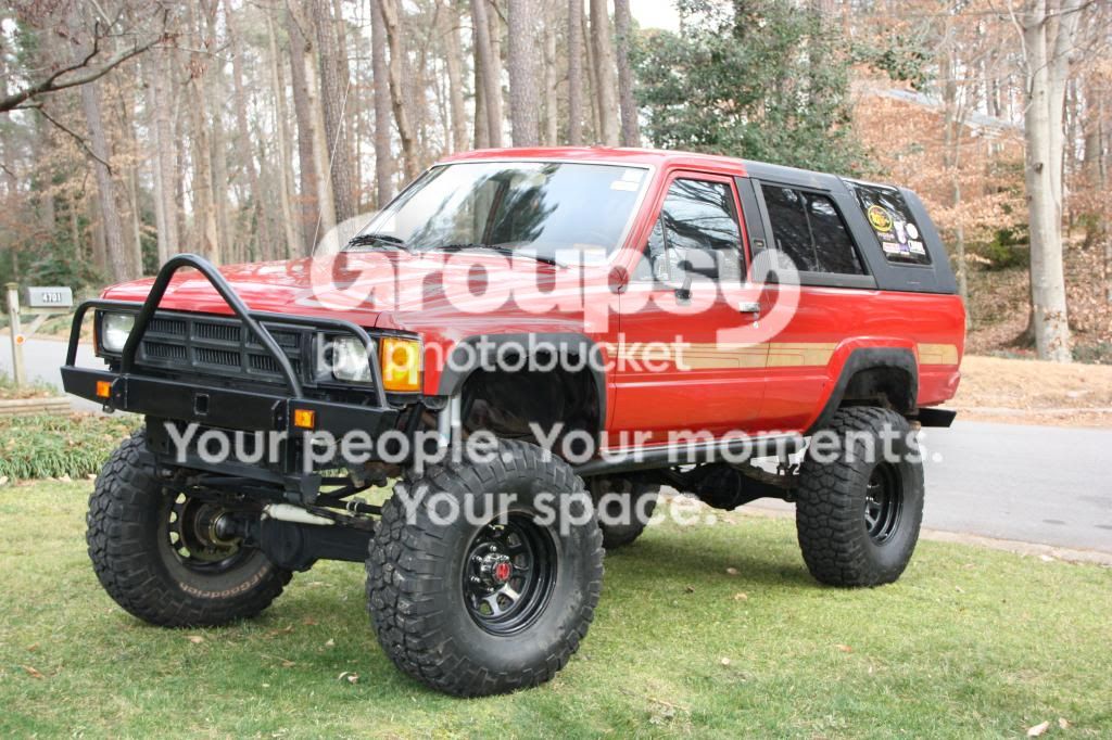

Got front and rear bumpers coming from addicted offroad, got a Superwinch 9.5K in the mail, and some new high strength enamel to prime and paint the frame with. Also ordered the last set of parts needed to install my CB. ...Cannot wait for Harlan, KY at the end of the month!
ajohnson, how's that bumper coming along?
So my addicted front bumper came in with just enough time for me to get it mounted with my new super winch. Painted it with with Rustoleum High Gloss Enamel both primer and paint. Ended up welding on the frame reinforcement plate, no gussets though, and wired in the turn signals. Need to finish wiring the winch to the battery; it comes with a circuit breaker and instructions say wire straight to pos+ terminal of battery but that's kinda ghetto in my opinion so going to get some isolators and quick connects tomorrow before heading to Harlan, KY on Wednesday!
Also put in a trail gear rear bumper before hitting up URE this past weekend and finally adjusted my valves. Did it a couple of months ago and got it right except for one that was WAY off. Topped off the tcase and crawlbox fluid and put lock washers on all my xmember bolts.
Also put a little custom stack exhaust on my friends Jeep Cherokee. It is traveling to Harlan as well and it was just too loud with just the header, so we had some fun and made it come out the top, much louder inside the cab haha just not on the outside.
Forgot to add i mounted up my tube doors as well with the 4xinnovations hinge kit. My body isn't straight because they didn't really line up well, but the BFH made it all work.
And for the winch, didn't need to trim any of the grille, but had to mount the fairlead before the winch with the bolts facing out. Took apart the inside of the control box and made sure all the connections were tight and routed the power and ground wires around the headlights and put them inside some rubber tubing to prevent chafing.

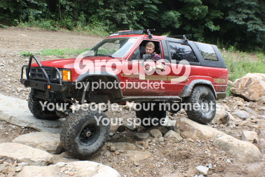

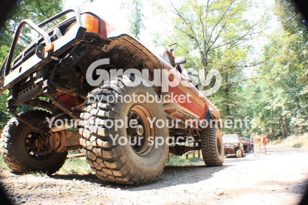

Had a great time in KY
Was able to run Railbed and Lions Den successfully before having to leave; always a great time.
