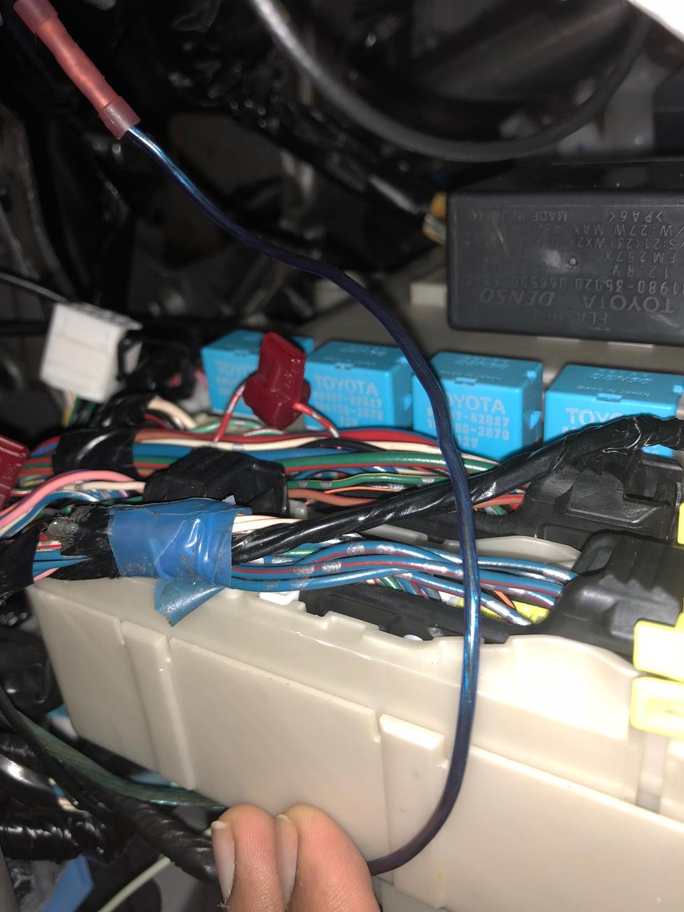

Does anyone have a diagram of the interior relays behind the interior fuse box? I can find the diagrams of the engine fuse box and the interior fuse box, but not the 4 relays in the back. I replaced the flasher relay but the problem still persists. I was wondering if maybe one of the other relays could be faulty. If anyone has any idea on what could be causing this problem please let us know! Trying to avoid going to the dealership at all costs.

that's odd that the new flasher relay makes it even blink faster. I could only think that the new relay you bought is bad too. could be coincidence but sometimes happen. return it and have it replaced with another one.
