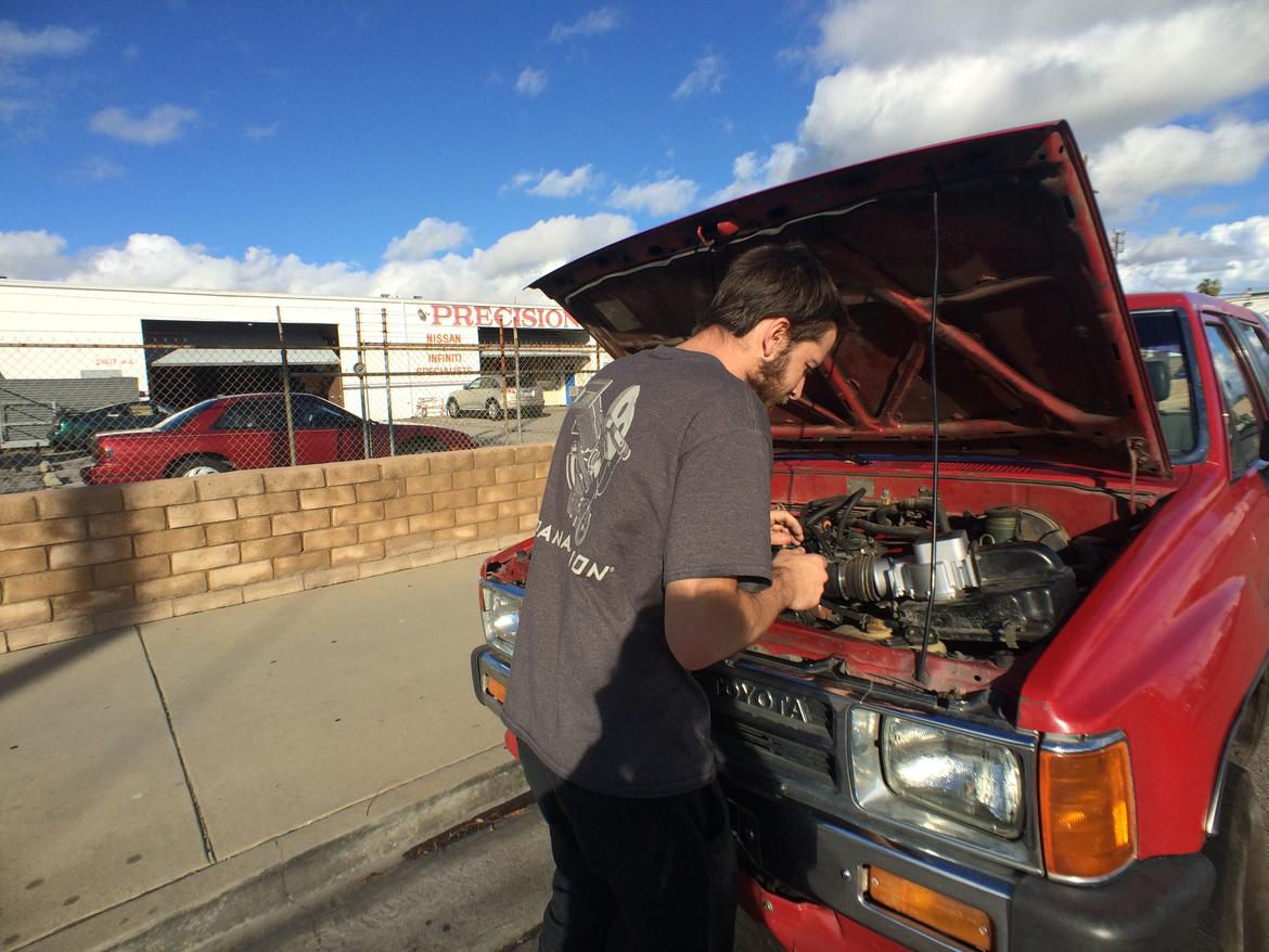

Box of donuts is a great idea. I felt bad for wasting his time but but I didn't have 500$. Paid him 40$ for the diagnosis and paid 210$ for the remand AFM. Drove around the block and put it on with my 10mm socket. T4R.org and its members helped me save 250$ thanks again guys I owe you all donuts!
