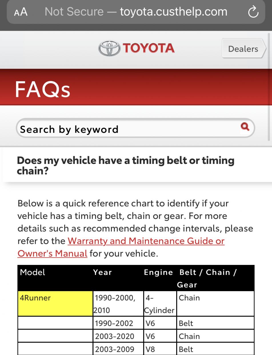

First things first, the V6 doesn't have a timing chain, it has a timing belt which is usually good up to around 300,000 miles, the V8 on the other hand has a timing chain that needs/recommended to be replaced every 90,000 miles.
Pretty sure the V6 has the timing chain even in the earlier 03-05 models? And the V8 has the belt.
[MENTION=444527]Yotascape[/MENTION] , yes you're correct and I know that the V6 has a timing chain and the V8 has a timing belt...I initially misread the post and it being late and my being tired responded with incorrect info without rereading his post, thanks for the correction, I have edited my response to remove that incorrect part!
