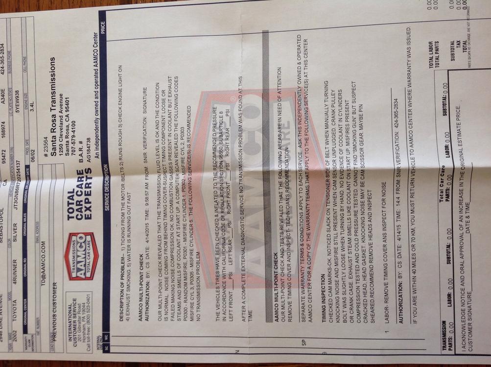

I own a 2002 4Runner, 2wd.
About 2 months ago, 3 lights came on during driving (check engine, vsc trac and trac off).
Went to the shop and they said the plugs are misfiring and replaced all the plugs. It lasted for a month and the lights came on again. But this time I have a ticking sound from the engine, the engine is really losing power and when starting the car in the morning the exhaust is smoking.
So I went to the shop again, they checked everything and said they think it's the timing belt. They opened everything and checked the belt which was fine.
Then they said they suspect it's the head gasket so they ran more checks for the head and everything turned out ok!!! (See attached pic for full descriptions).
Now they are saying that my choices are to send the head gasket to inspection and see if it can be fixed or to change the whole engine!!!!!
Both option are really expensive and I wanted to see if you guys has some other ideas or recommendations.
Thanks in advance for any thoughts, tips and info.
