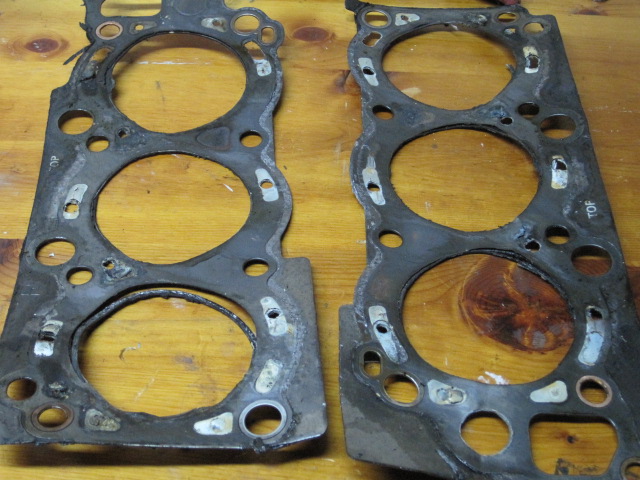

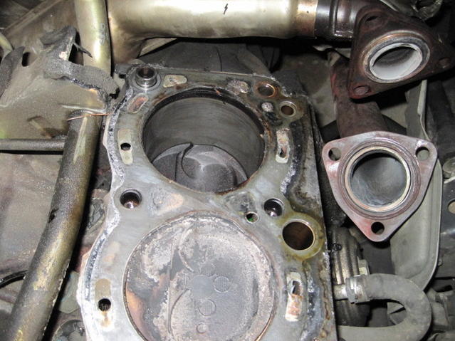

Update!
Found milkshake during last oil change. Pulled the heads and found HG blown again. Last set lasted 47k miles. I'm alomost done replacing them. Maybe, third time is a charm...

Did I have the heads checked to see if they are flat? Maybe the block is no good...what did u do the last time u did the heads? Rebuild?
Those are such a PITA. I would buy new heads, that's what I did in my 88 however I parted it out instead of fixing it.
Maybe you should invest in some headers this time around, 6cyliners. You'll pull the heat away from that back corner where the gasket usually fries, and you'll get a nice boost in power for the effort. That way you can consider the money spent as an investment, instead of merely an expensive repair.
I concur, headers are the way to go. That way you ditch the crossover pipe. Your heads will like the heat reduction that's for sure

I third that on headers it seems like most 3.0l head gaskets go out on driver side near cross over!!!!! I know thats where mine blew out as well. If you do redo the heads at least put a better heat shield around the cross over.

Last time I had the heads redone and check block with straight edge. Headgasket came from enginebuilder(sp?) Ted I believe. This time I was kinda pissed. So, I oredered a cheapest set from ebay with headbolts and slapped it back together. Hoping to get 2 more years out of it while looking for another core to rebuilt or ls 5.3 swap.
my 3.slo is at 318k and last time I had the HG replaced was more than 100k-150k miles ago... Check your block, the heads themselves, and if there's additional heat going to the HG's for possible leaks or anything of the sort.
