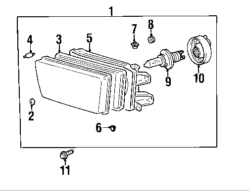

I obviously can't guarantee that you will get glass headlights instead of plastic, but I am 99.999% sure that you will - even the aftermarket headlights for our trucks use glass lenses. In fact I've never seen plastic lenses on 3rd Gens. I think the word "composite" that is throwing you off is not referring to material of the lens, but to the fact that it's an assembly of several pieces (lens and housing). Note how in the parts diagram above, they are calling the same assembly "Lens and Housing" for RH side, and "Composite Headlamp" for the LH side. So I think you'd safe with these.

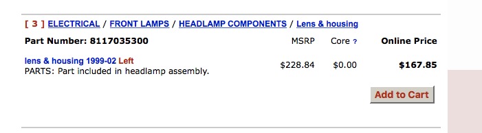

I see quite a few 99+ headlights online for under $200 brand new. Like this - 81170-35300 - Genuine Toyota UNIT ASSY, HEADLAMP, LH
The Camelback site shows that part number, 81170-35300, as the "lens and housing", not the complete assembly. In the diagram, #1 is the complete assembly, #3 is this part.
The whole reason I had replace my 97 headlight is because the plastic mounting bracket failed---metal screws into brittle plastic---not one of Toyota's best engineering decisions.
The headlight was still working OK, except of course the 21 years of dust and oxidation cutting the output from the reflector. I'm getting a new 97 complete assembly for the other side.
Good point - the part numbers above are for the lens and housing, without the backing piece. That's all you'd need if you just wanted to upgrade from '96-98 headlights to '99+, like the OP was asking. But that won't work in your case, where the backing piece was broken. Can you find a used one at a junkyard?
