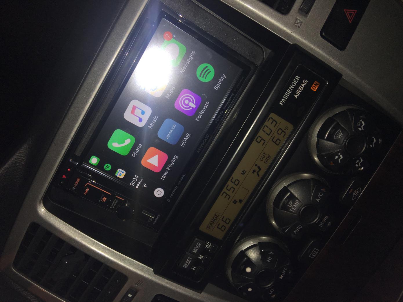

Just to chime in the radio he has is similar to my old one except mine has some other features. I believe it has the same amp inside so for mine it made a really big difference over stock. here is a picture from a while back. Just disregard the apple carplay part.

Well I would want full touch screen ofcourse. I hate the look of those multicolor little ones you see in trashy cars haha.
But I don’t need it to do much if you catch my drift, just a decent head unit for a fair price and withgood quality
And I see yours for around 250, i actually really like it, does it improve factory speaker quality at all? And do you happen to have a picture so I can see it in a 4runner?
Yes, I've had it for a week now, and I noticed an increase in audio quality, though I will be throwing on a cheaper set of speakers (still no dedicated amp) in a couple days to hopefully bump it up some more. I'm just happy to be able to play music from my USB stick.
