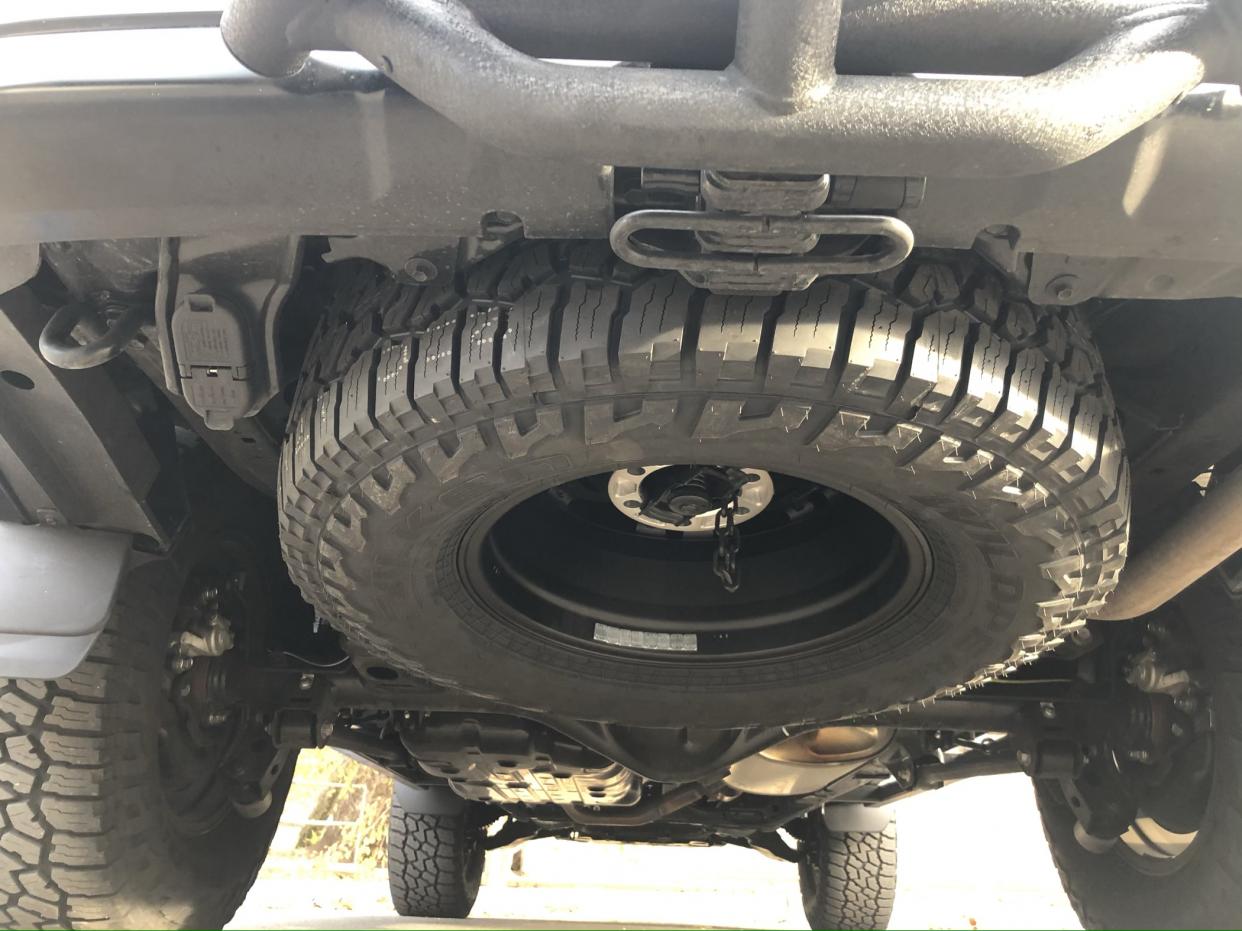

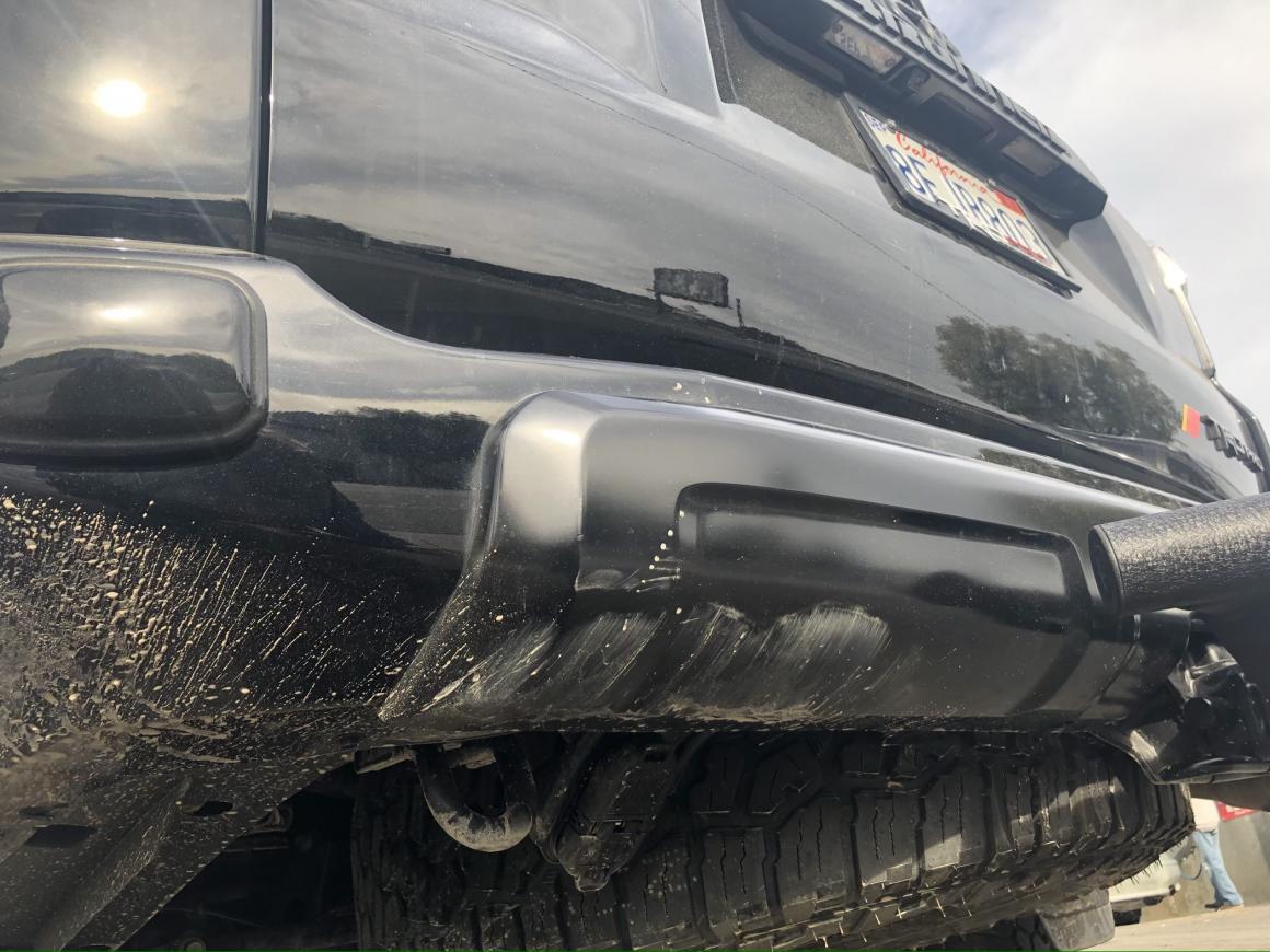

I run 285’s all around on my Pro with a 1.5/1” spacer lift. I have a matching 285 on a Pro wheel that I do a 5 tire rotation with. As far as clearance, I did scape the bottom side of the bumper and probably my spare in this pic, but did not see any damage to the tire. And the face of the wheel points upward so it won’t get scraped. The differential still hangs lower than the 285. Go with a 285.

Go with the 285's (they're an inch wider than the 255/80's). I run the same setup as TRD Panther and while it has hit the ground plenty of times with the many trails I've ran in several states including Utah, there's no damage to the spare at all. If anything it's kinda like a bumpstop lol. I just did Valley of the Moon a week ago, and going down the gatekeeper it slammed the spare and hitch really hard, and still nothing wrong at all with the spare.
Maybe keep the spare at 20psi (if you have an air compressor) so it flexes more than being at full pressure when it contacts the ground.

Nope. I think if you have KDSS it is really close and may rub slightly, but will not interfere with the function.
Agreed 285s rub slightly on the Kdss sway bar BUT doesn't interfere with the function. I tested my 285s first under it then tried it with my 255s which cleared with plenty of space to spare.

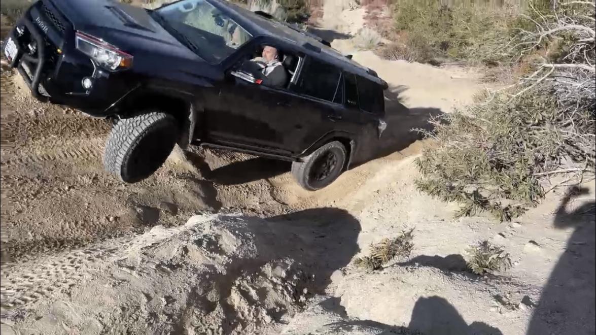

Some of the comments surprise me because I would put it the other way round: for Black Bear, you need wheel travel above all, not extra ground clearance. Some folks drive Mineral Creek (and Black Bear) in Foresters or XVs (downhill only).

But that's me. Different people like different things. Except for front wheel travel. It matters a lot and lifts above 2" only rob from capability, don't add to it. I am on like 1.25" and with stiff suspension, it is plenty. With a soft suspension, it would hit a lot.
EDIT: to be more specific, the rolled Toyota videos and pics I have seen on Black Bear come down to wrong line plus lack of front wheel travel, particularly on one spot before the rocky switchback. I have also seen Jeep pictures roll at the start of the switchback were they hug the wall too closely on the right (easier mistake to make than one may think). So if the OP is headed there, don't do Black Bear without prior offroad experience and understanding of how to handle off-camber spots.
Either way is fine. Your trailer hitch is going to take by far the most abuse as it is at the back end and the departure angle limit.
Yup. I used to keep there a short recovery insert and it did a fantastic job at saving the hitch. For example, the very steep rock on the southern loop of Fins and Things where even new Rubicons scrape.
I now use a 35$ hitch skid plate meant for front hitches. It does not have the better design of the 160$ offroad hitch protectors but it does the job at a fraction of the cost. And I don't have to use locking pin to protect the protector lol.
