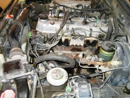

The stock manifold came off great!

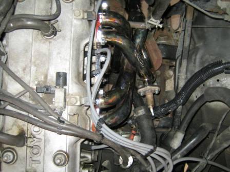

With a little finessing, the new header installed well into place. I began by torquing all the nuts to 10 ft/lbs then 20 ft/lbs.

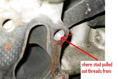

At about 18, however, two of the studs began to pull themselves out of the head. At 20, another began to pull out.

I ended up buying a Heli-coil kit from Napa, 10M-1.25 ($63). Rather than installing Heli-coils in all the holes, I only did it in the three failed ones. After installing the header for a second time, with a new gasket, all was good untill I got to about 25 ft/lbs. Then the rear lower stud stripped out, and two other began to pull out of the head.
I finally installed Heli-coils in 6 of the eight locations (all but the center, lower two)

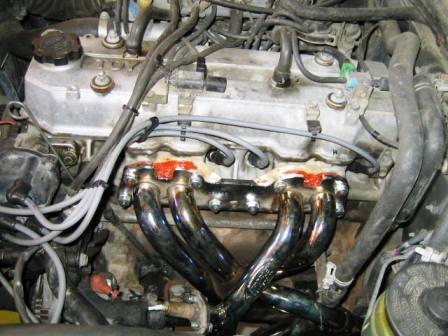

Every stud got a shot of red Locktite before being installed into the head, and then a heavy treatment of Red RTV on the manifold-side of the gasket (as seen in the image). I applied blue Locktite to the studs before torquing the nuts with lock-washer to 33 ft/lbs.

It runs great now. No leaks. I have to say that the sound is not as pleasant as with the stock manifold. After all was said and paid for, I think it cost me at least $100, and MANY hours more than I had anticipated.
If I could go back two weeks, I would have just left it alone. My 4r was running great, with a top speed of about 85 -90 mph. I can't feel any increase in power and it feels slower as I try to approach 80, but I haven't tried pushing it beyond 80 yet. I guess we'll see.
