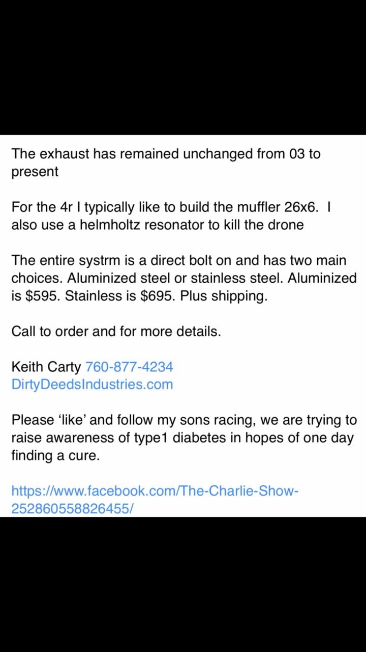

Talk to Keith at Dirty Deeds Industries. He specializes in custom performance exhaust set ups with no drone for the Tundra and Tacoma. He sent me an email saying he has a custom performance exhaust available for the 4Runner.
His BA Muffler is considered one the best on the Tundra forums.
He can probably do other performance mods also.
