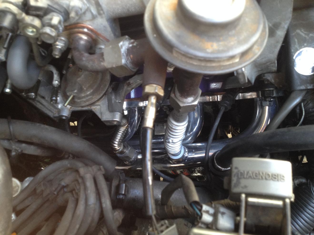

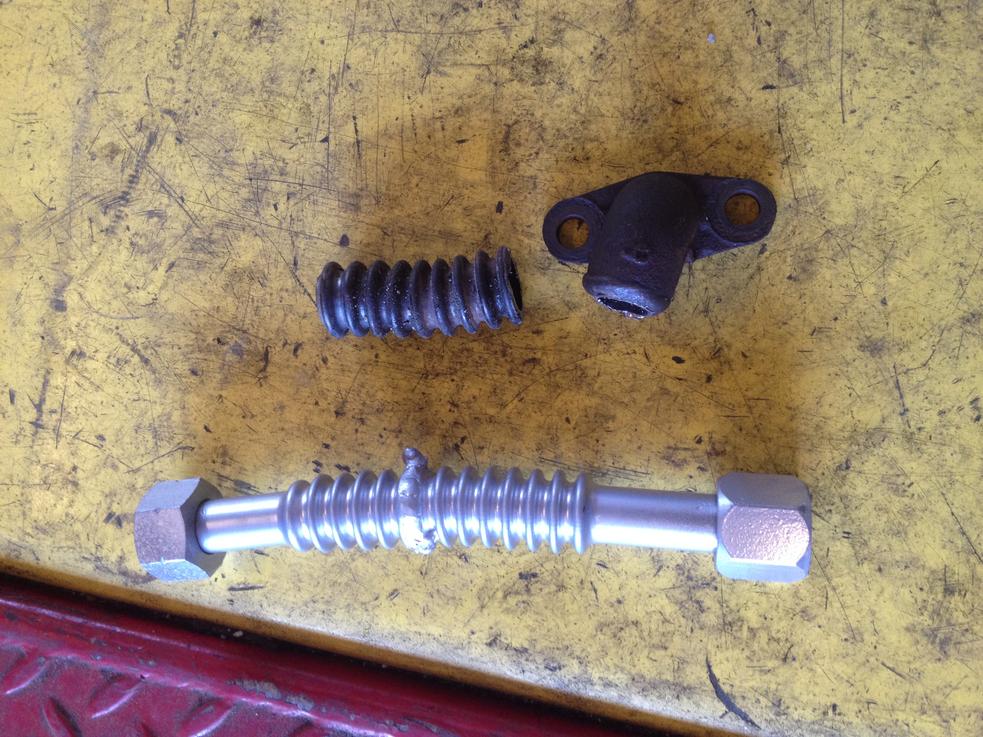

I am installing the Doug Thorley headers on my 4WD 5speed. It has been a little tight so far. And the parts supplied for the reed valve and EGR didn't work the way they intended. I will take some pics tomorrow of how it's going and the modifications of the tubes for the EGR and reed valve.

Here's how I modified the tubes for the reed valve and EGR. On the EGR I used a torch to heat and straighten the original tube. Then cut off the manifold end. After that I cut a section from the middle of it and welded it back together to fit in
