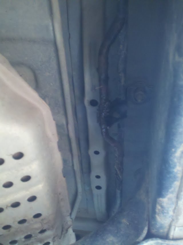

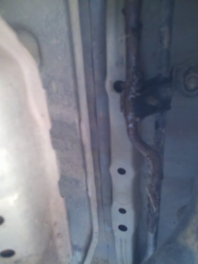

K guys new update to the problem...Discovered where the leak is coming from. It's coming from what it looks like a heater core line or something that feeds from the engine and runs back along the passenger side and looks to feed the heater/ac in the center console....It's a hard line that's pretty corroded and seems to be leaking from the bracket. Anyone have this happen?

Rear heater line, common problem. Get some 3/8" rubber fuel line (about 20 ft), long zip ties and some hose clamps. Cut that rusted metal sh*t out and replace it with the rubber lines. Use the hose clamps to attach it securely and then use the zip ties secure the hose up on top of the frame rail.
