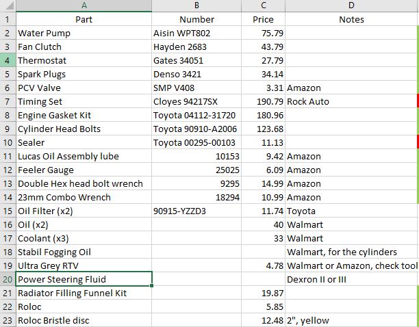

Does anyone have a shopping list put together for the headgasket replacement on a V6? I've read a few threads, but can't seem to find all the parts laid out.
Things I have:
Valve grind kit - 04112-31720
Double Hex tools - CTA Tools 9295
Things I'm not sure on:
New head bolts (x16) - 90910-02162 (replaced by 90910-A2006) - are these required?
Chains / tensioners - 230k on the truck, I'm thinking about just reusing
Anything else?
Thanks
-Rob

Here's the parts list from when I did it. Definitely get new head bolts. Other items of note:
The CTA 9295 tool is hard to get fully into the head bolts. Clean the old head bolts really well before trying to use it, but I had to use a hammer to tap it into the new bolts too. If you do it this way you'll hear a distinct 'pop' when it's fully seated. It's seems like a good way to strip a head bolt, which I actually did. Don't let this happen, it sucks. I've heard of people using a tri-square instead, you might want to get both just in case. I think the only link I could find to one was through Snapon I think it was $30+.
The Toyota Sealer on row 10 is for installing the timing cover and you'll put a small line on top of the block where the cover, block and cylinder head meet. If you have the FSM from on here you should see this step in their description of the job. When you install the timing cover you use this to seal the edge of the cover and two tear drop shapes that are for the water pump I think. You'll see the old sealer when you pull the timing cover off, it feels like rubber when dry. Some people use RTV for this, but the Toyota stuff is worth the $20 I paid for it at my local dealer.
I also replaced the front oil seal (behind the crank bolt) while I had the timing cover off. I think I bought this from my local deal, but it's much cheaper online. This wasn't leaking, but I figured I was already there so I might as well do it.
I didn't end up replacing my timing set so I don't know if the Cloyes set I thought about using is any good. I did break one of the long chain guides and bought a replacement from Rock Auto that has worked fine for the last 15,000 miles.
I used a roloc and yellow bristle disc in a drill to clean the block mating surface after I head the heads off. It works really well and isn't strong enough to make the mating surface uneven.
I also went ahead and replaced the water pump, thermostat, spark plugs, fan clutch,and PCV valve since that hadn't been done yet.
I'm going to assume you know what everything else is for, but ask me if you don't. Hope this helps.
