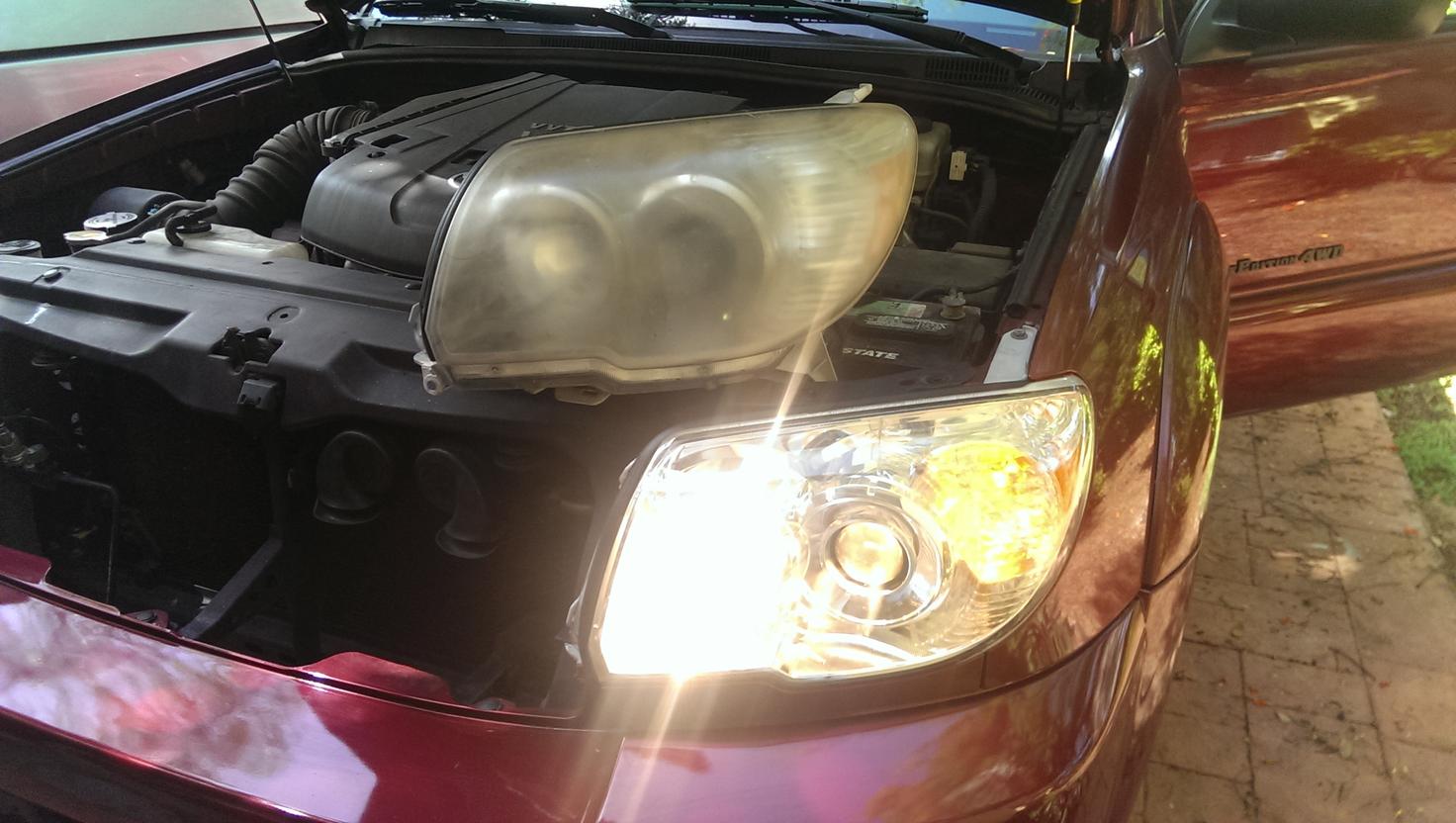

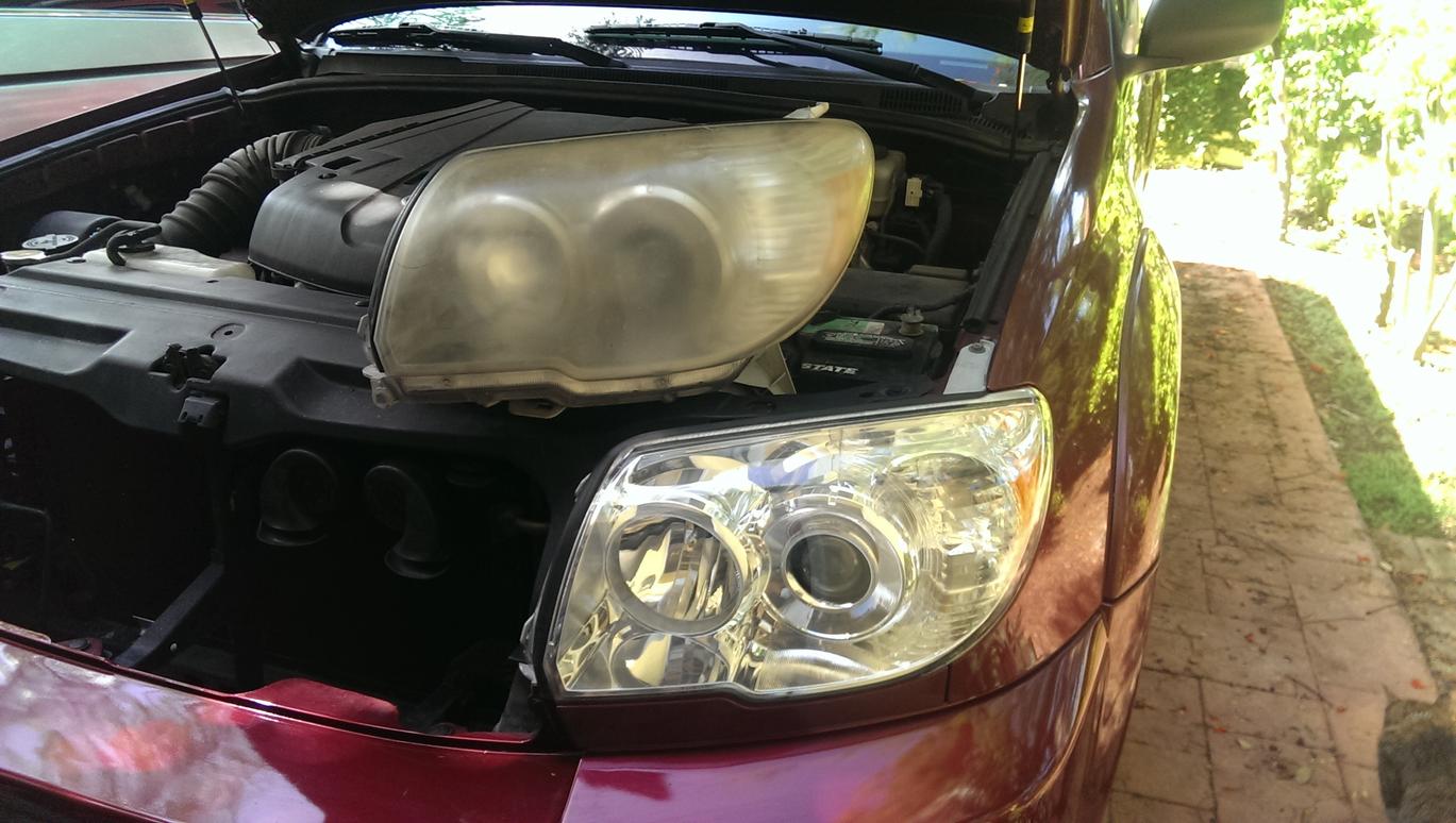

total time .........25 min............ 5 out of 10 difficulty.
Found a refurbished headlight online for $37 (incl shipping)

Wow! Your originals have just about the worst clouding I've ever seen, lol. Miami must not be kind to headlights.
I wish you could have taken pics, I cannot figure out how the hell to remove that thing.
You're missing the forth screw found between the side of the headlamp and the outside of the metal body. Hard to explain it but if you search it I've seen some threads on here showing you were to look for it.
