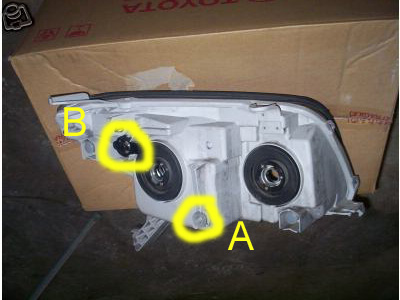

Does anyone know how to adjust the headlight aim? I saw one adjusment, but when I tried adjusting it, it looked like it didn't do jack sh!t, so can anyone provide any info or pics of adjusting it? Thank you!
This should help you out:
A: Just use a screwdriver to adjust it. I believe this one makes the light go up or down. Clockwise makes it aim downard and counter-clockwise makes it aim upward.
B. You need to unlock this one, push the tab from the horizontal position downward, then use a screwdriver to adjust it. Remember to lock it after adjusting it.
This is a picture of the driver's side I found on eBay, just so you know which light you're dealing with.
