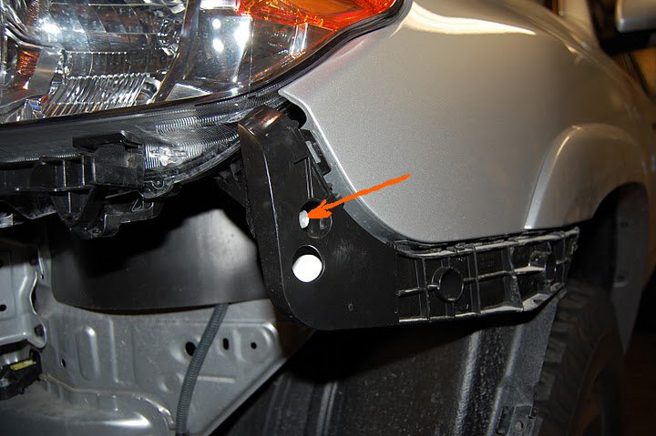

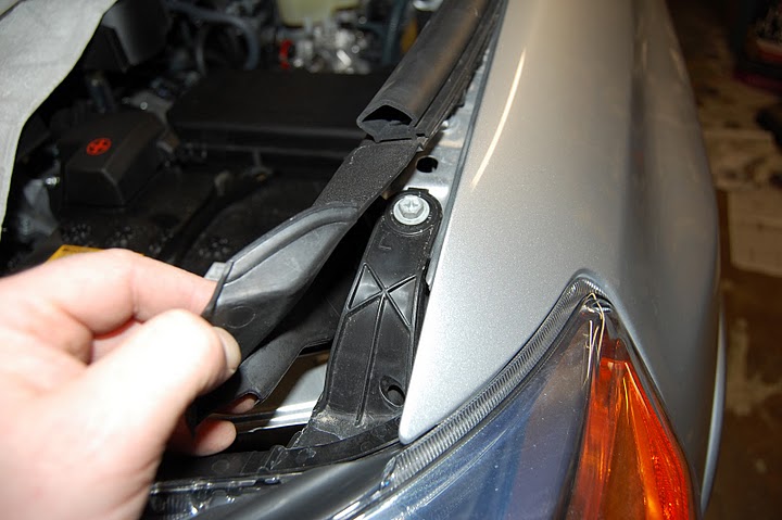

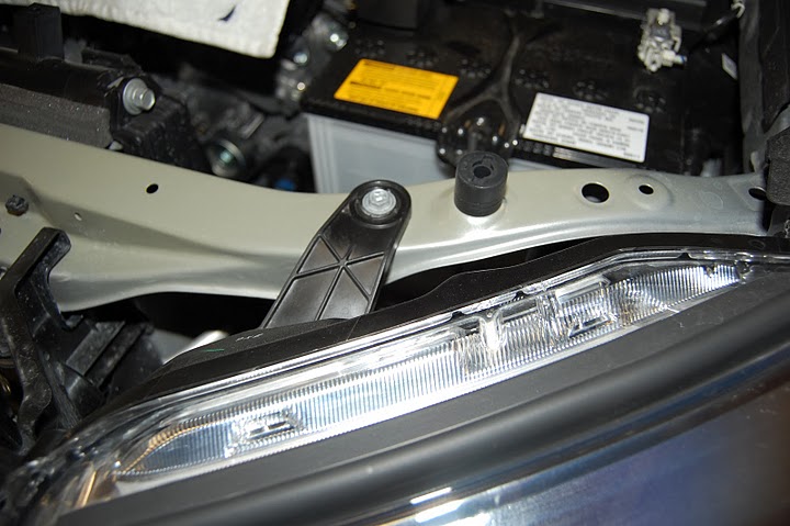

Unfortunately ,you have to take the front bumper cover off first to remove the front headlight assembly off.
First ,unplug the elec. connector.Then there are 3 bolts and it slides into an alignment bracket off the subframe on the bottom.
The 3 bolts as pictured on the drivers side.
