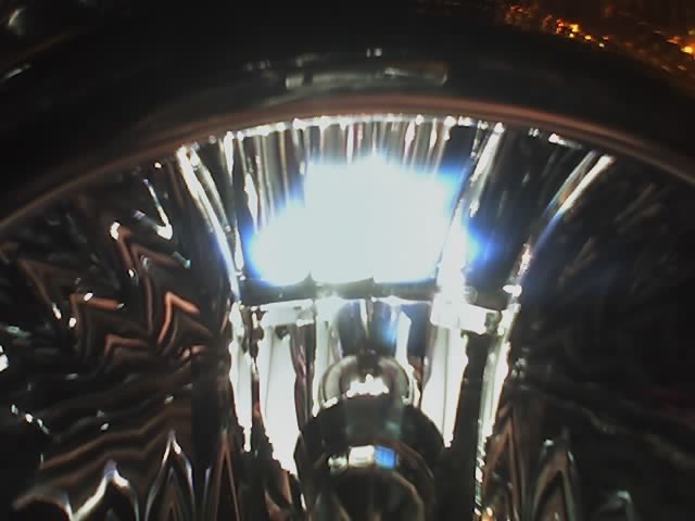

Before the I got the Silverstars, I put a pair of PIAA Star White 3800K 51W-->100W in my LB housing. After being on for about 30 minutes they got hot enough to burn the reflective coating on the top of the parabolic reflectors.
I'd be really careful about putting extra-bright bulbs in that are rated at this high wattage. I also noticed some burning of the wire harness.
It was like this on both headlights. Notice the dull spot above the light itself. This did not noticibly degrade my beam pattern however, because the top of the housing reflects closest to the vehicle, a spot my fog/driving lights illuminate.
