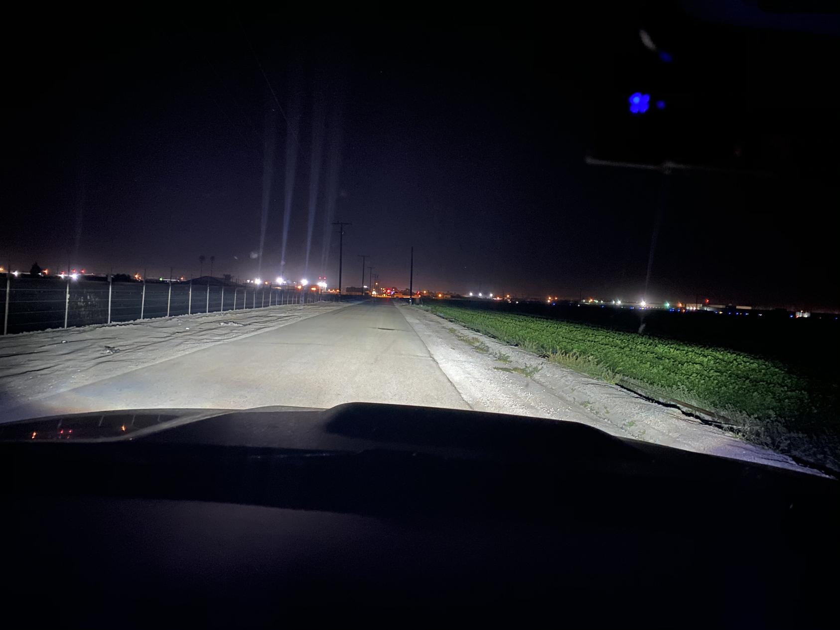

By trial and error I kept on looking for the best, non glaring to oncoming traffic I could find. I took all these photos in the same spot give or take 1' and cell phone camera front and center on the steering wheel to try for accurate pics. No fog lights in any picture.
All of these were aligned per speck using a laser level for accuracy. Most shops or streets are pitched for drainage so it's very hard to find a perfect flat spot at 25'!
I've got explanations at end of the post about the different findings.
This link can explain much better than I could. Simply put the 4runner projectors with any non halogen bulb will mess with oncoming traffic because of the horrible spread of emitted light. It's a good read and suggest you read it. All the manufactures and reputable sellers have disclaimers on all the headlight bulb websites, usually in small print about Led and Hid bulbs are not street legal in the US in stock halogen projectors.
3rd Gen HID vs LED vs Halogen H11 projector headlights | Tacoma World
Special thanks to [MENTION=208721]mynameistory[/MENTION] for trying to tell people about how bad these bulbs are in stock projectors. I could have saved money had I listened!
This first picture I would like you to notice the dotted line of reference(the crack fill in the asphalt) on all the lights of how the different lights spread up close. The other marks show where the usable light stops and how far the beams project. Also note the height the light cast on the tree trunks to the right side. Remember all these lights are laser aligned for an accurate comparison.

Adding OEM LED... if you can get over the black spot poor cut off drivers left (I did) its not bad, save your cash if you have a 21 and keep them!

1. Stock oem H11 philips
So the halogen does not have the "cool white" look but they have more usable light than any HID or LED that I've used. We all know the stock lights are terrible!

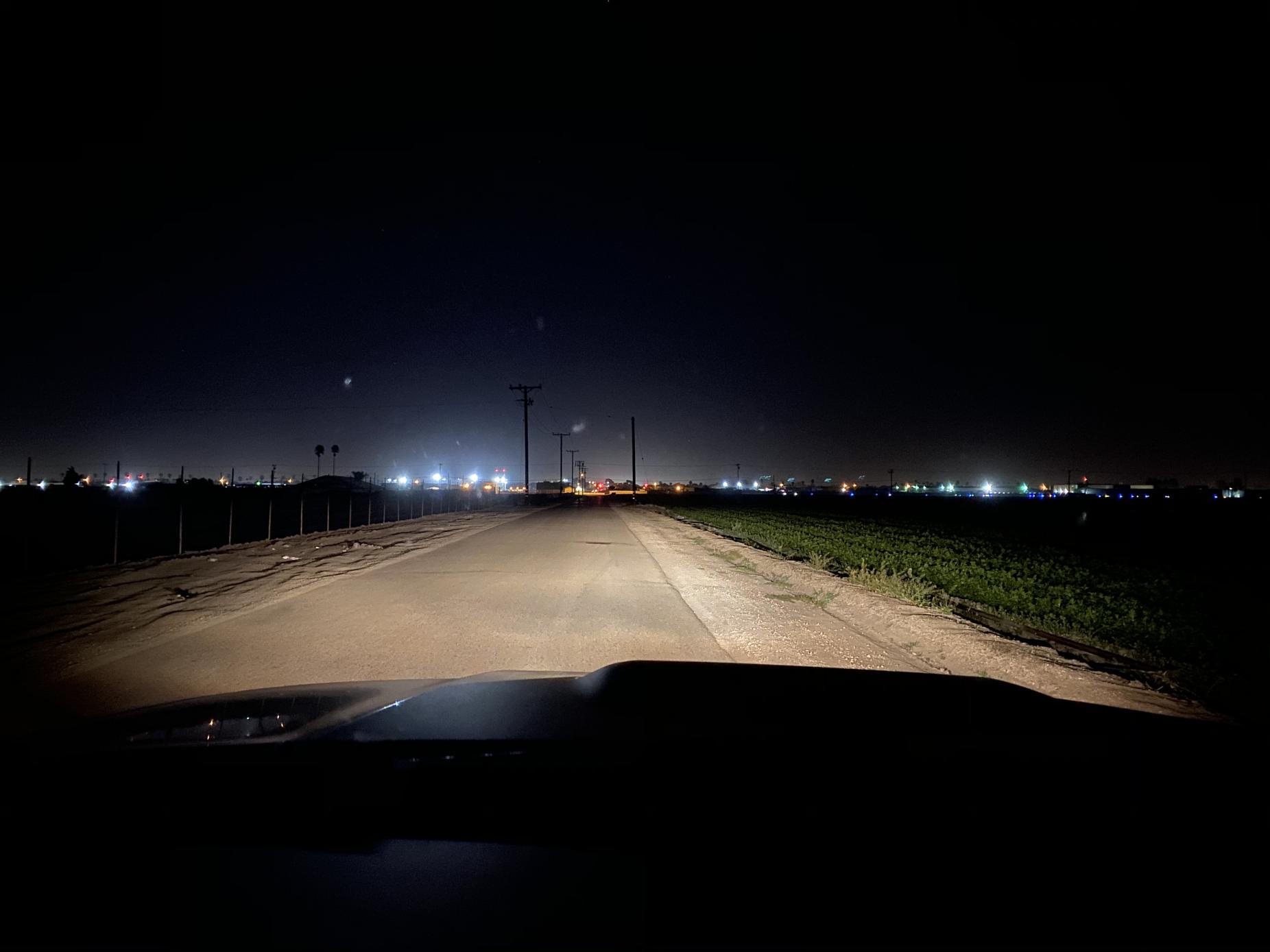

2. H9 philips - Halogen
Easy cheap replacement, hours of reading no ones melted wires or lenses. Easy to trim the bulb tab once you do it. may be intimidating before hand, just do it!
3. H11 philips xtreme 100 - Halogen
I found them just as good as the H9 without a need to cut the bulb socket. People say the longevity is bad but for the bang for buck of being able to see over stock a good investment. Other members have noted many other H11's that are as good, some claim better but I did not try them.
