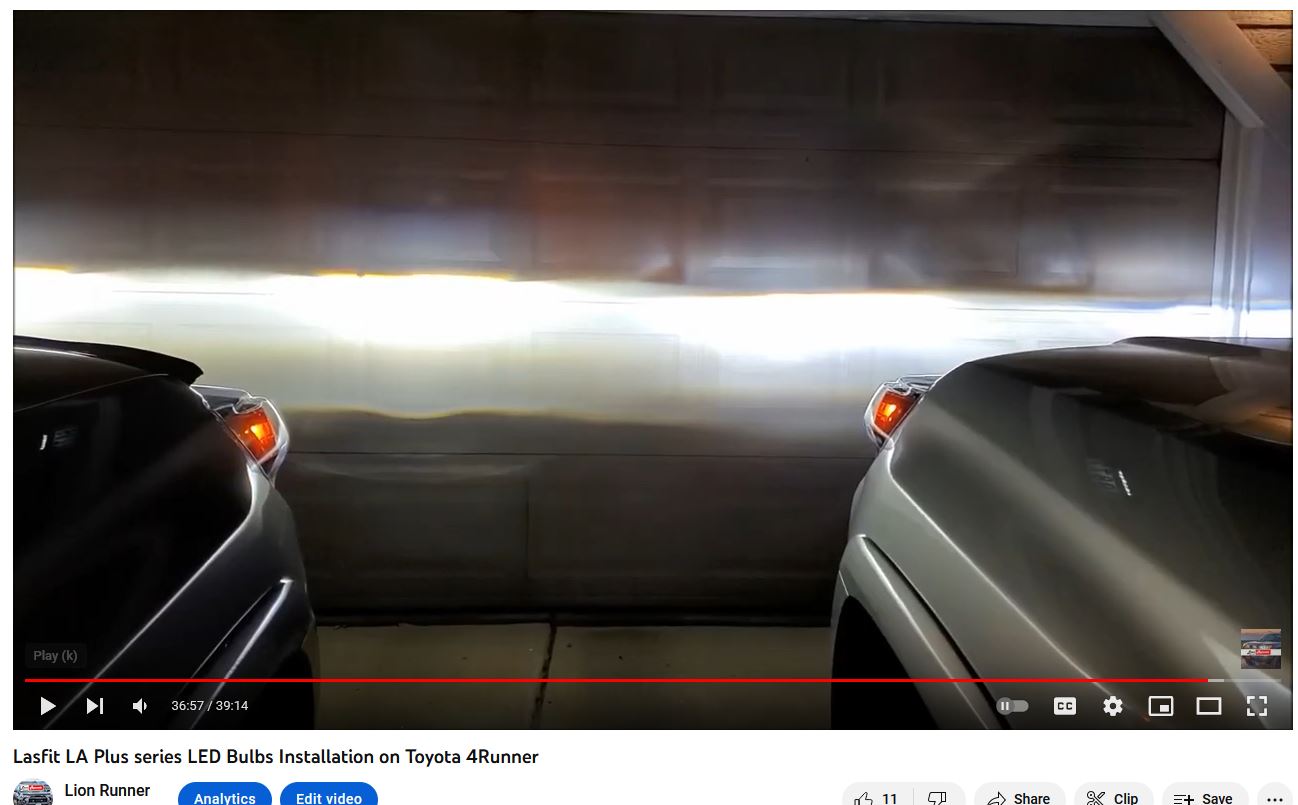

This thread convinced me to get the Lasfits low beams for my 2019. Huge difference.. They really show their stuff when out in the sticks where no street lights are. OM I had to squint, as I am 55 years old, even with Rx glasses on at night.
I may do their High Beams.
