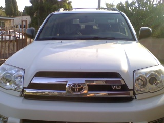

M mario552k New member Aug 31, 2010 #3 Direct fit yes/no there is a gap on the corners and you must also purchase a couple extra parts. Did a write up on the plugs you need to get for the lights to work right. http://www.toyota-4runner.org/audio-electronics/47596-06-headlight-wiring.html Attachments 0318090002.jpg 31.1 KB · Views: 438

M mario552k New member Nov 20, 2010 #5 05T4RV8 said: What kinda parts do I to do this mod? Can anyone provide a list? Thanks. Click to expand... Click the link right above my picture it jumps you to the forum where I listed the parts you need to get the lights to work on your runner
