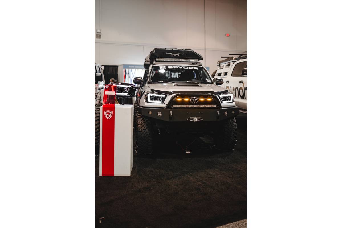

Wow. These look promising. I have been planning a retrofit to freshen up the frontend, but if these are decent, I may go this route.
The thing that worries me is that these are all show, and no go. On their website, it says they're halogen and any install of HID/LED will void their warranty. If I'm going to upgrade headlights, then I need them to actually work better than the crappy halogen we have in our trucks now.

The pricing for the Spyder headlights are $225 plus shipping and tax for a set. This is what a rep said in regards to them being halogen "These come with halogen bulbs, we don’t recommend HID bulbs because sometimes you will have to modify the housing and that will void the warranty."
This is what they said on a reply to me on Instagram about that too, "correct, the platinum and apex series will be led, you can wait for those as they will be available at a later date"
ugh. please don’t bother with any of these dime-a-dozen, cheap-ass, China-sourced “turnkey” headlight replacements. if you want to be happy, just have a fresh set of OE headlights retrofitted by a professional with your choice of HID or LED components.
For $225 I'm going to give them a shot. Worse case is I don't like them and I put the originals back in. I can always sell them and get some money back too if I don't like them.
