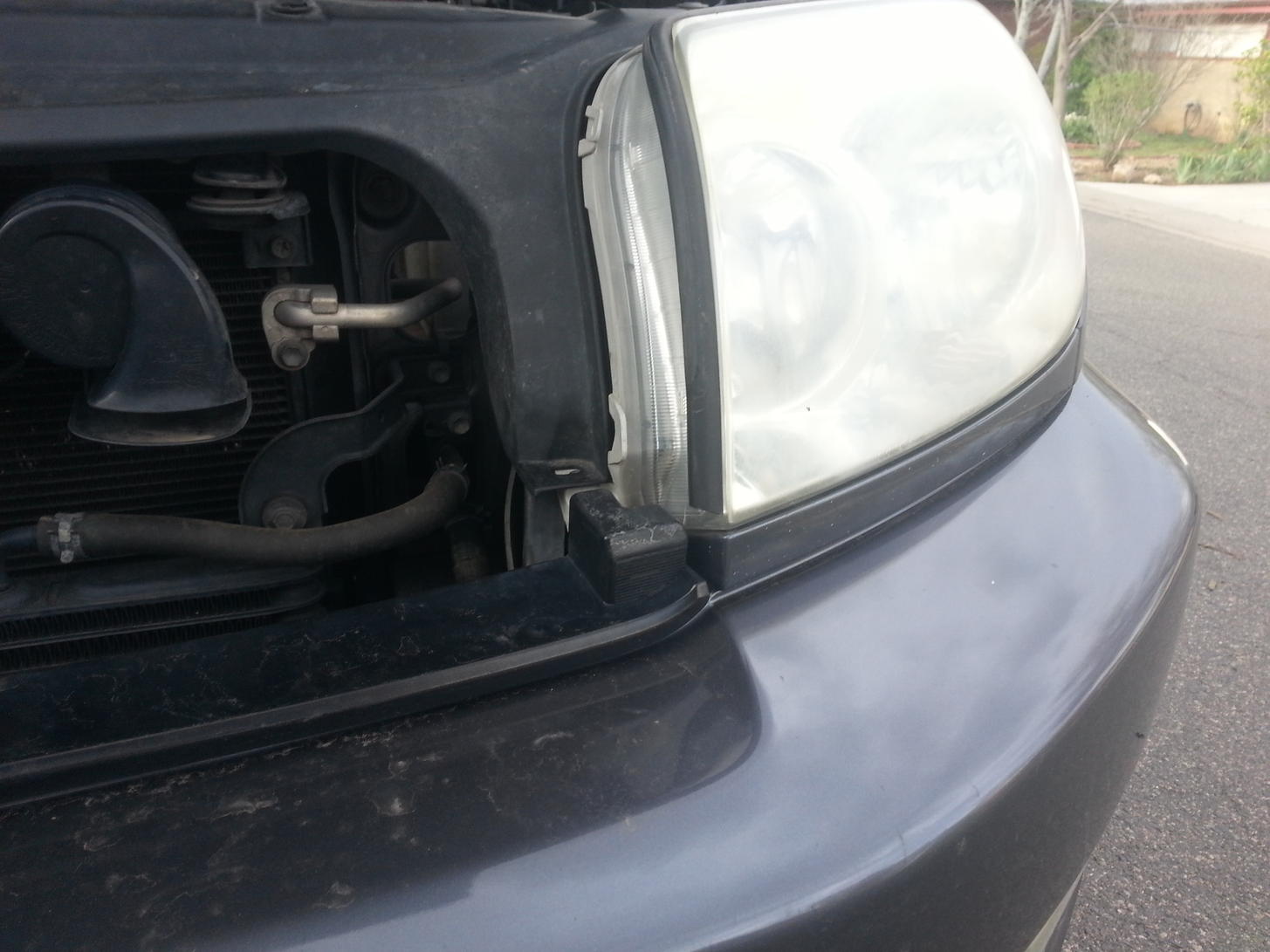

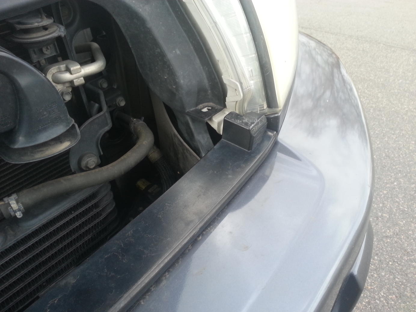

Im not having a problem with the bolt in the wheel well I can't figure out how to get the front one off anyone have this same problem? It seems overkill to take off the whole bumper for ine bolt .all

There are clips on that black piece, pull it off, and you're gold.

I couldn't figure this out either because you can't tell which way the black molding comes off. I finally discovered it comes off by lifting it straight up. There are a number of brackets holding though. Some of them broke when I removed it.

Wow, I've removed my headlights a lot but never removed that trim piece. I never figured out how it comes off and I didn't want to break anything.
