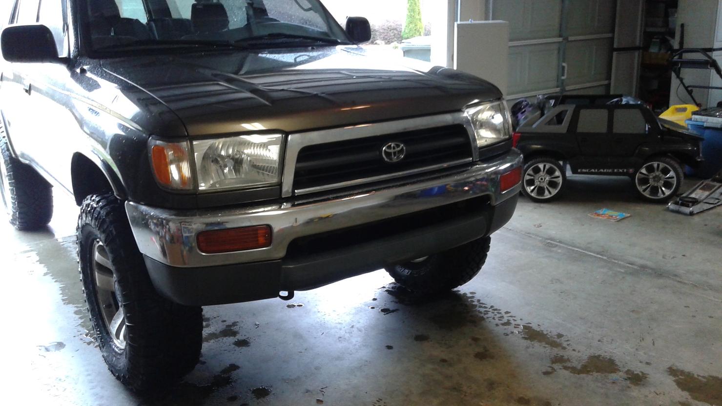

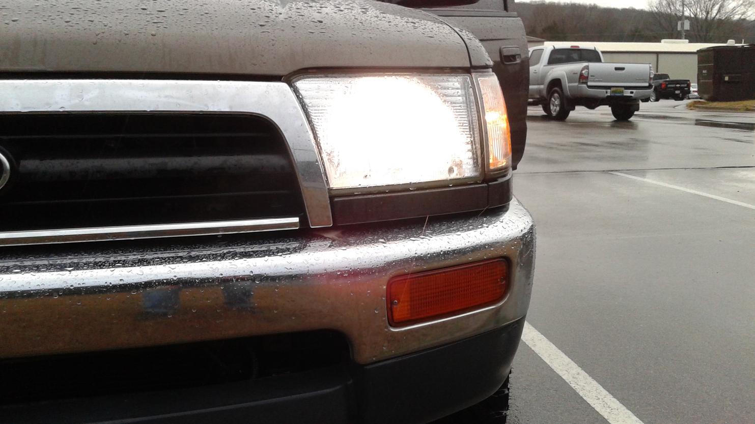

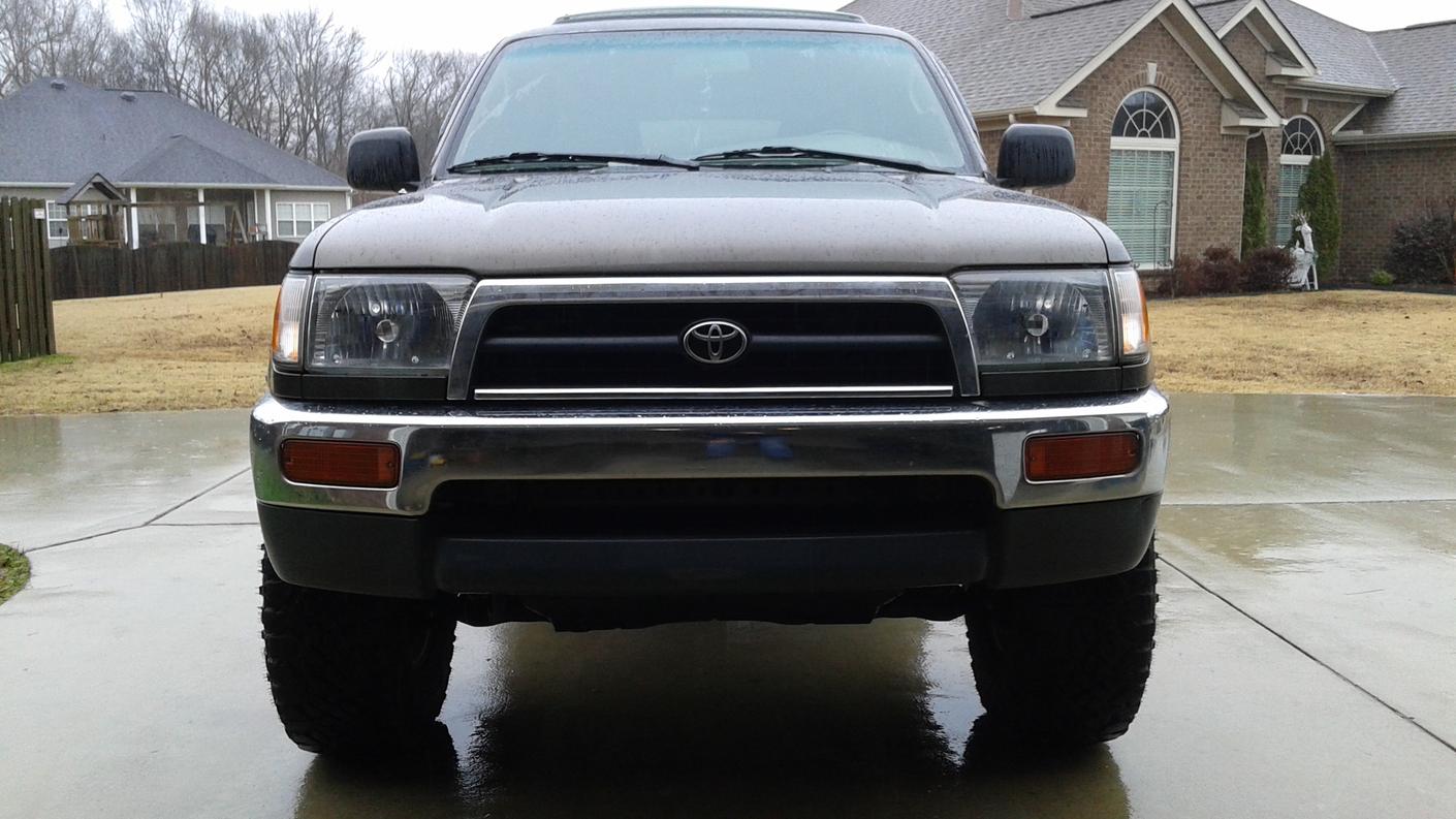

Yes, brittle plastic, broken clips...etc...PITA. Not to mention one of the mounting studs was broken on one of the 02 headlights I bought, so I had to Gorilla glue one off my old headlight on to that one...did I say PITA. Waiting for that one to dry and cure good but I managed to get the driver side in last night and I'm not really convinced that it is any brighter than the old ones, maybe a little dimmer. Cosmetically it looks better, buy functionally, I am not sold yet. Maybe I can adjust the little standoff thing inside the headlight to focus the beam a little lower, it looks to be focused a little top heavy. Any tyricks on how to fine tune these things? Thanks.
Let me clarify on the fine tune thing....I am not talking about using the adjuster. I didn't move them, so they should still be good, but I will have them checked anyway. The beam itself inside the headlight looks bright on top, but a little dim on the bottom. I have the PIAA Intense White bulbs too, but I could tell the beam is not as strong right in front of the vehicle as it was with the old housings. Thanks.

Bummed to hear they weren't as bright as the old kind. I was hoping the opposite was true as well, my passenger side glass is cracked and was looking to do the same thing.
Yeah, I'm bummed too. I'm gonna take it to a friends body shop and aim them with his machine. Hopefully, that will make a difference. If not, I'll just change them back. I would hate to because these look so much better but I would rather see at night than look good....
Yea that's odd to me. But I might now why. You said they were used. There's a good chance the inner shiny reflector has a film of grime on it from over the years. That will do it.
