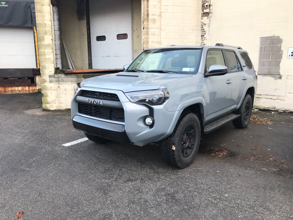

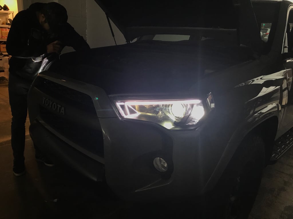

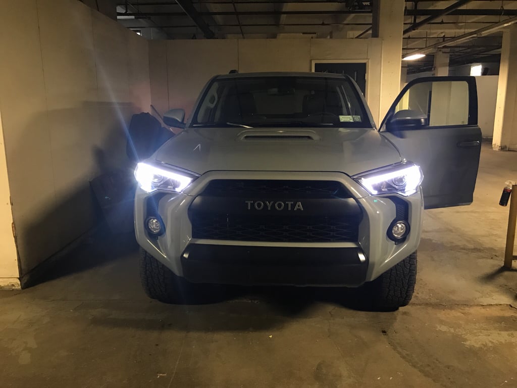

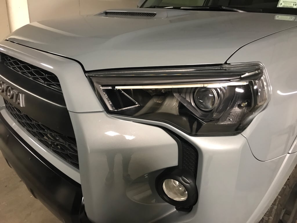

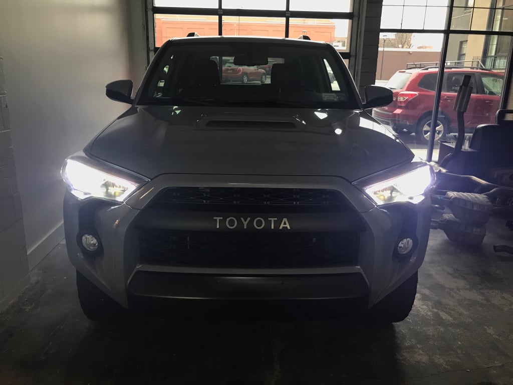

Hey kids,
I cannot stand the headlights on the 5th gen. Why toyota thought a 40k truck needed just halogens is beyond me. Especially one that's meant to navigate treacherous areas. On top of that corollas and tacomas just have better lights. So I've always wanted to modify them. Couple that with how terrible the chrome housings look on cement, with the trd emblems, it's just plain bad.
So i went to my friends at Circuit Demon, and they went to work. I didn't want anything egregious. Just clean, understated, and frankly if the quality id hope for for 45k.
I took a couple quick phone pics. I've got some better shots I gotta get off the camera. But honestly I was just so excited.
They;
-paint matched the housings and blacked the rest. No more chrome.
-upgraded the projectors to bi-xenon
-upgraded high beam to LED
-added LED accents for DRL
-removed ambers.
They could do so much. Etch logos etc. I just wanted what looked like it should belong.
They can do your lamps for you too. Check them out on IG @circuitdemon tell them I sent you.

Those look pretty sweet! The HID projector retrofits are no doubt an upgrade in performance, but are the LED bulbs in reflector housings really better than 9011 HIR bulbs? (not hating, I'm an LED fan when it's in the right application)
retrofitting is definitely the way to go. Waiting for mine to get in in a few weeks. Have HIDS in stock projectors, and they are definitely crap.
I think most use the housings out of the IS for the retrofit and the bi-xenons are nice even though most of us rarely use high beams. I wish someone would get bold and do a retrofit for active headlights. I always smile jumping out of the 4Runner and into the BMW when the headlights turn and light the way!
