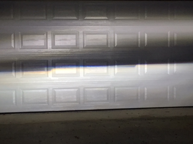

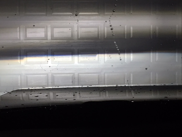

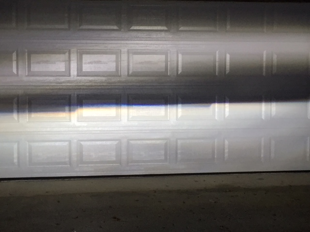

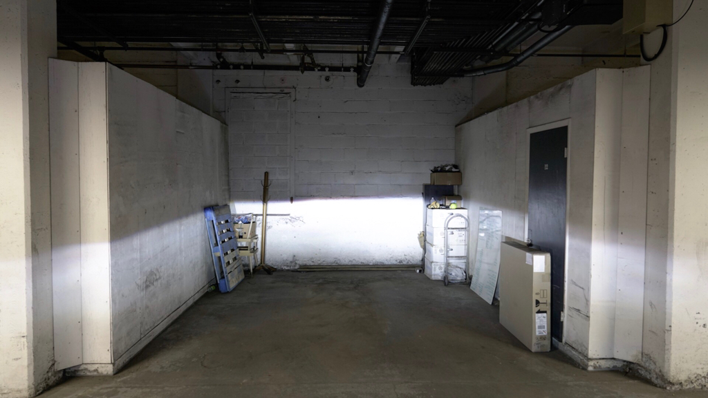

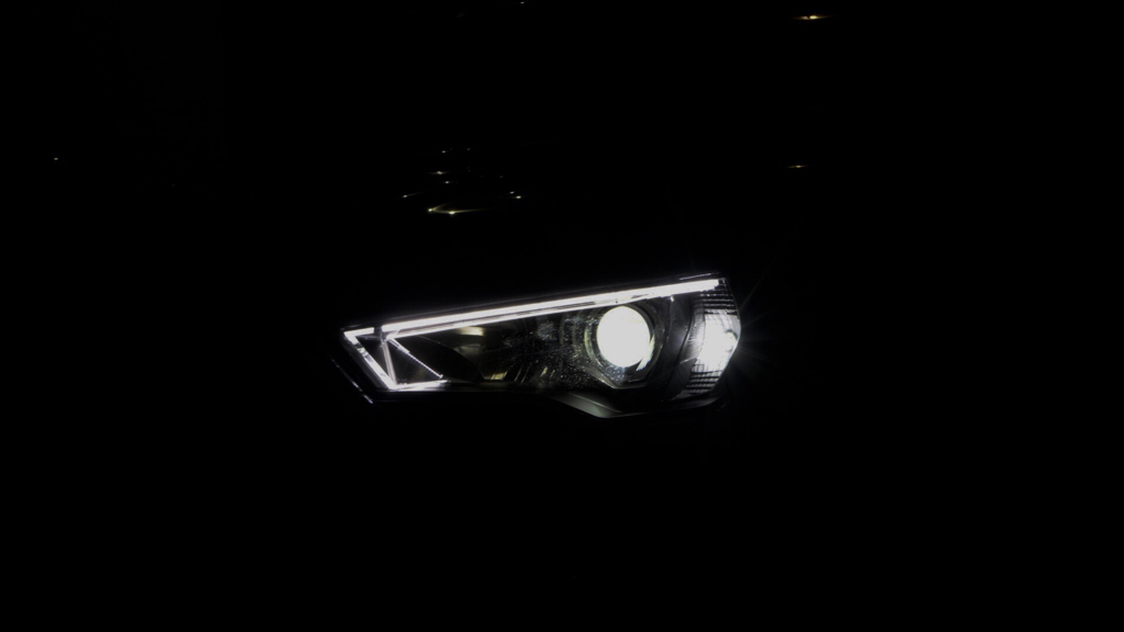

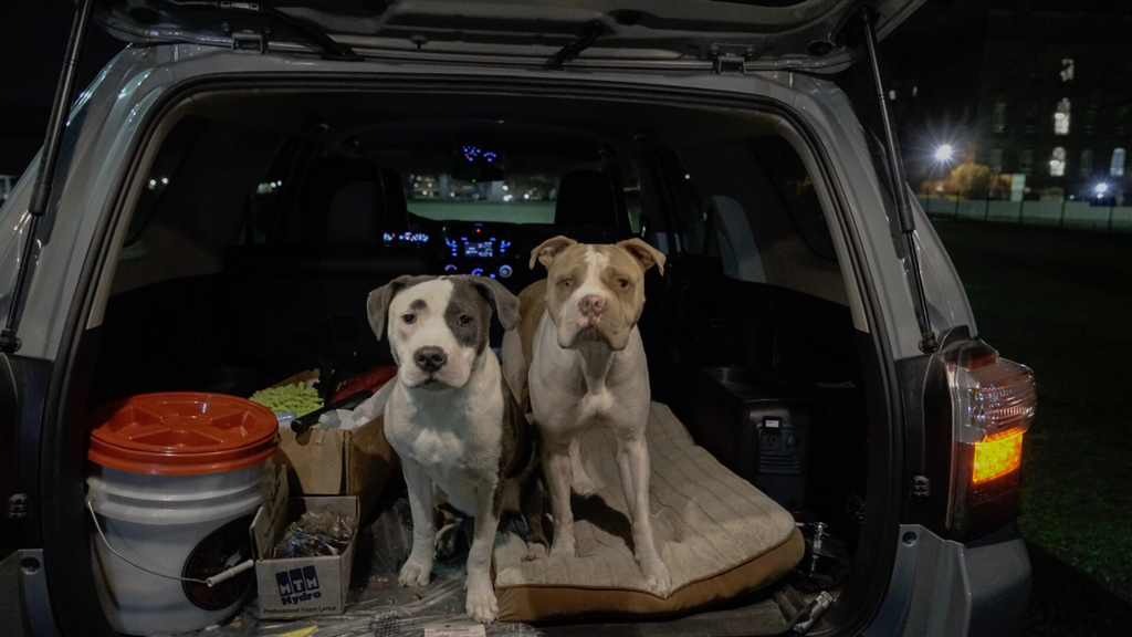

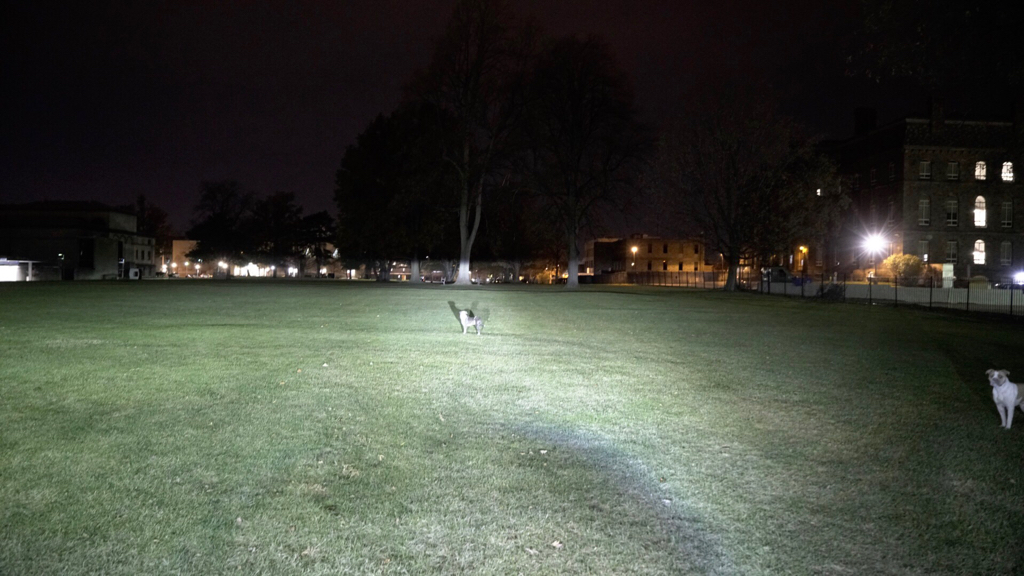

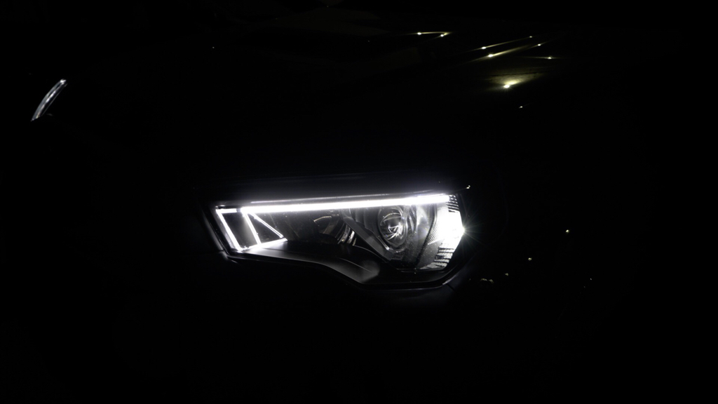

Here's some better night shots and better camera.
All on in housing besides high beam
Indoor beam, sorry I'm parked on a rug remnant they're normally not uneven. Just realized this.
Bc dogs
Night beam with intruder
Just LED on

Let me clear up some confusion. I misspoke excitedly. They are not bi-xenon projectors. They are upgraded oe projectors. New lens ballasts and hids. I opted to not go for the morimoto bi-x to save some money as the high beam could now be upgraded. This was their recommendation andnthis is their expertise. for high beams we went LED in stock configuration and displaced drl to led accents.
I did none of the wiring.

The IS projectors are Bi-x. And yes, there is a harness that operates the halogen HBs with the HID HBs.
You could upgrade the OEM projector with a clear lens and an HID kit and achieve pretty good results. I have pics and lux readings from Lightwerkz for this mod and they are quite good actually. And this does save a few bucks.
For me, going to all the trouble/expense required to get the lights out, and opened up, is no small task. So to go to the extra step of buying the IS projectors made sense to me. They only cost $100/pr., and labor was probably a few hundred more. Lenses are a wash, and the HID components are a wash. Made sense to me.
