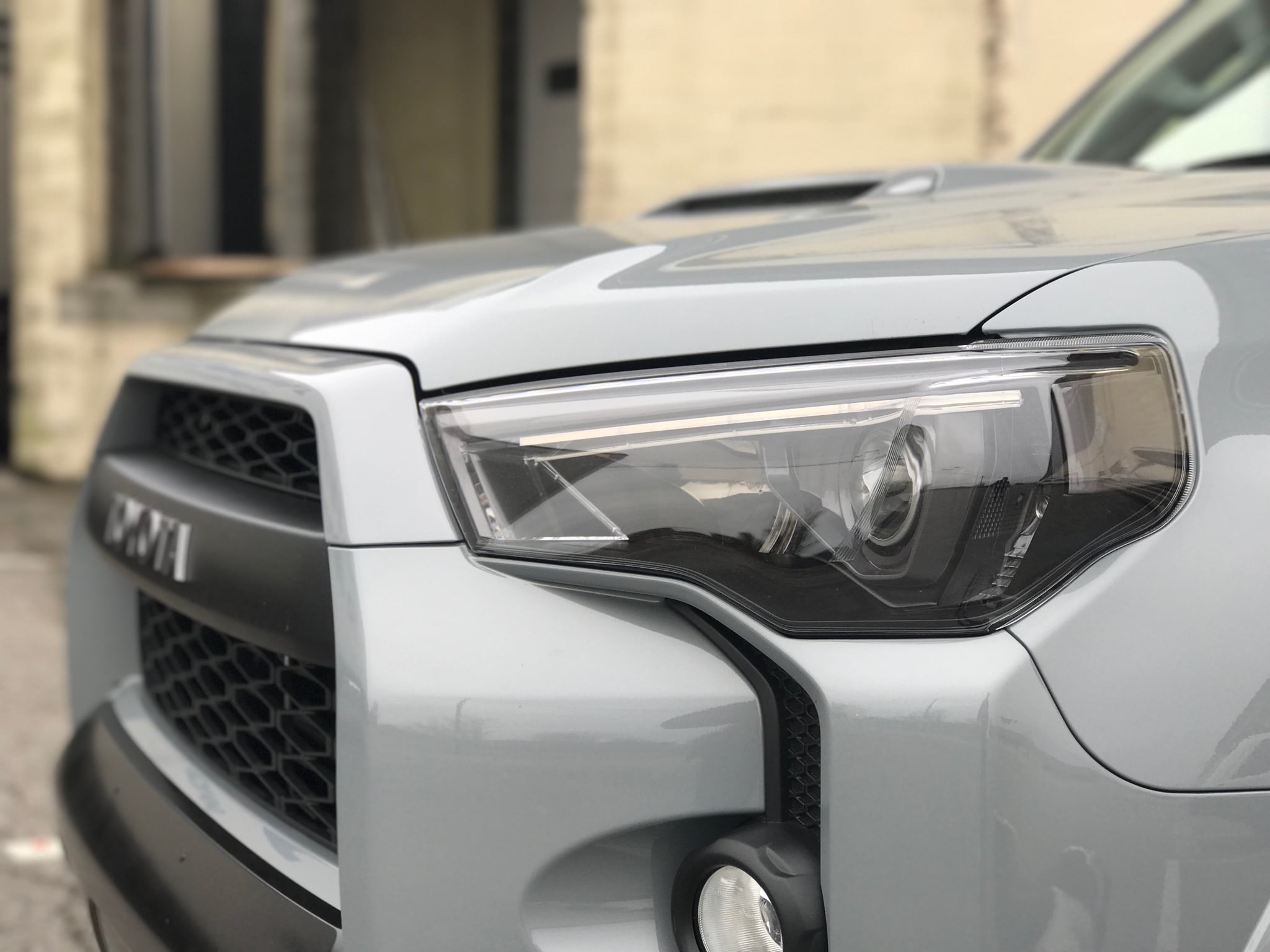

The led strip is also behind custom fit acrylics.
wow, this looks fantastic! might have to skip the XD HID kit and save for the real deal. I love the LED accents as turn signals idea. very Audi looking which is a good thing.
Maybe was my inspiration having just sold my audi. They look very s3

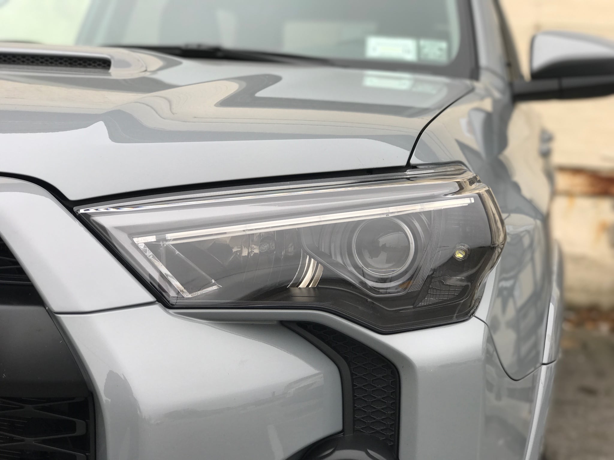

The IS projectors are Bi-x. And yes, there is a harness that operates the halogen HBs with the HID HBs.
You could upgrade the OEM projector with a clear lens and an HID kit and achieve pretty good results. I have pics and lux readings from Lightwerkz for this mod and they are quite good actually. And this does save a few bucks.
For me, going to all the trouble/expense required to get the lights out, and opened up, is no small task. So to go to the extra step of buying the IS projectors made sense to me. They only cost $100/pr., and labor was probably a few hundred more. Lenses are a wash, and the HID components are a wash. Made sense to me.

Lenses are STI-R but not etched.

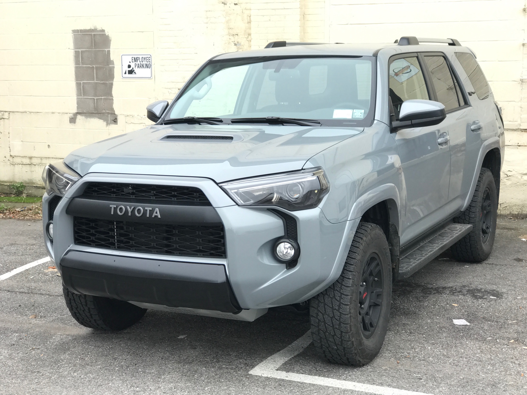

The light is great but the color match is the real winner here.

Parts alone (including replacement headlamps) for my retrofit was in the ball park of $500. Another $500 for professional labor is well worth it.
