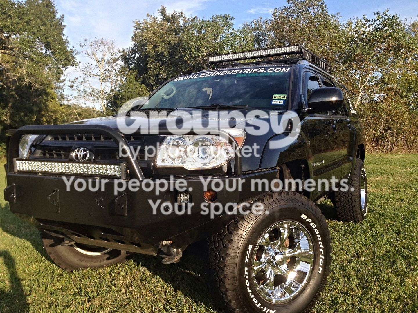

Its not too expensive and its a HUGE upgrade for looks if you swap to the 06-09 head lights. Heres before and after:
Before:
After:
