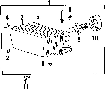

What you can do and should do:
1) buy a set of TYC "OEM compatible" cheapo lights off EBAY ($75 a set)
2) Bake and swap over the clear TYC glass (see my how to thread for info)
3) Buy better bulbs ...Install PIAA bulbs ($45), 4300k not hyper white (6000k = lower lumins)
PIAA 10704 Night Tech 60/55 Watt H4 Upgrade Bulb - Pair : Amazon.com : Automotive
4) If you housing piece is broken then buy a new OEM one or try the TYC
Remove the adjustable black housing piece and replace it with a new one. $40.
OEM Parts Online ----> Camelback Toyota Parts - Genuine OEM Parts - Free Shipping
99 Headlight Assembly ---> 1999 TOYOTA 4RUNNER Parts - Camelback Toyota Parts - Genuine OEM Parts - Free Shipping
5) Do NOT swap out the OEM light reflector because that is what determines the light pattern.
---> The cheap non-OEM reflector's light pattern is always well HORRIBLE ....
I don't know if you can only swap the TYC adjustable plastic but you can buy it for about $45 online per side at CamelBack Toyotas ONLINE Internet Parts store (not main store)
DIAGRAM BELOW
