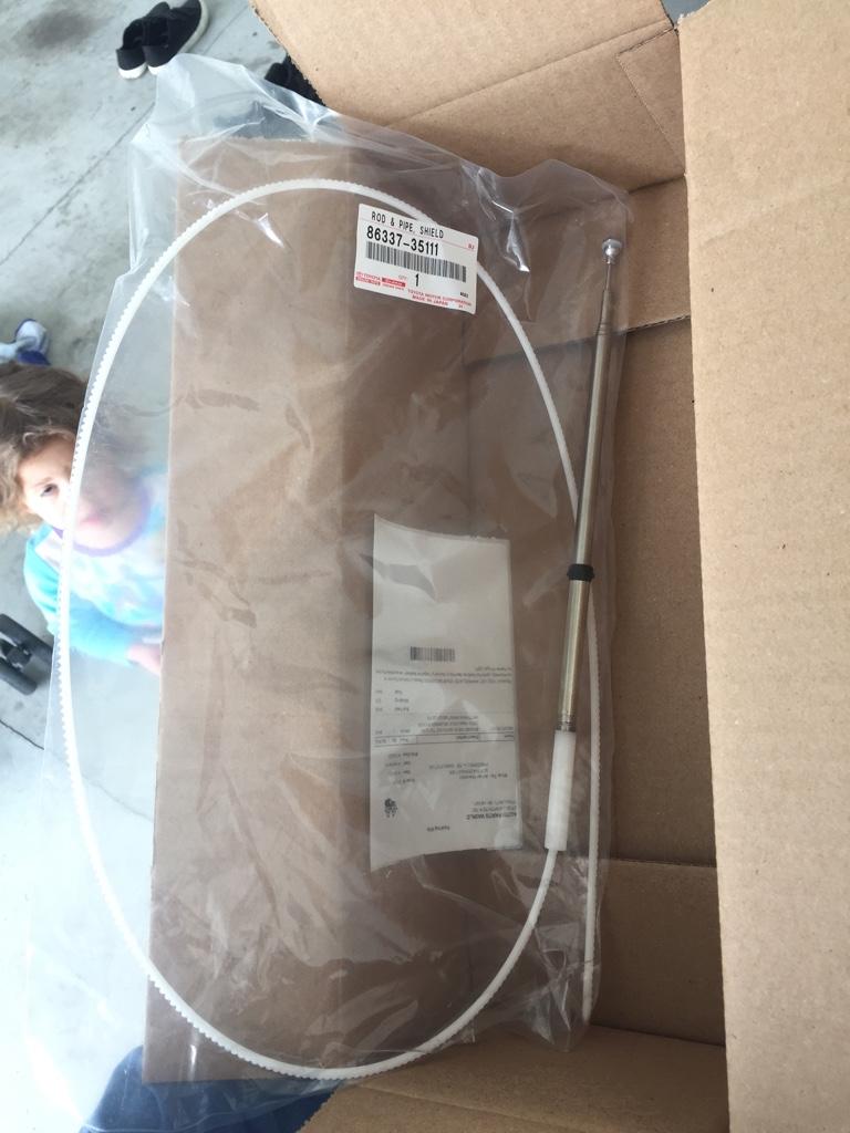

Got this on eBay. Just the telescoping mast since my motor worked. Works flawlessly.

That’s good news. My motor still run, you can hear it, but no antenna movement. Do you think I can just replace with that?
You Absolutely can. Very easy swap also. Took 5 minutes.
1. Unscrew the silver/chrome ring at the antenna that has the 4 notches and take it off along with the black piece that sits between the vehicle and screw.
2. Turn your radio on, this will make the motor extend the antenna.
3. Pull the telescoping antenna out.
4. Extend your new telescoping antenna and face the cable teeth forward (towards the passenger headlight) and insert the cable into the motor until you feel resistance.
5. Have someone turn the radio off and the motor should grab on to the teeth of the cable and retract it into place.
Make sure you guide the antenna into the hole while the motor is pulling it down. They reattach the black piece and chrome screw and your all done.

Oh also put some lithium grease on the teeth of the new antenna before you install it.
This should work as long as your old antenna cable teeth didn’t break inside the motor.
If the cable did break inside the motor, you’ll know because the motor won’t retract the new antenna fully or at all. Worst case you’ll have to take the antenna motor out and take out the broken cable from it.
