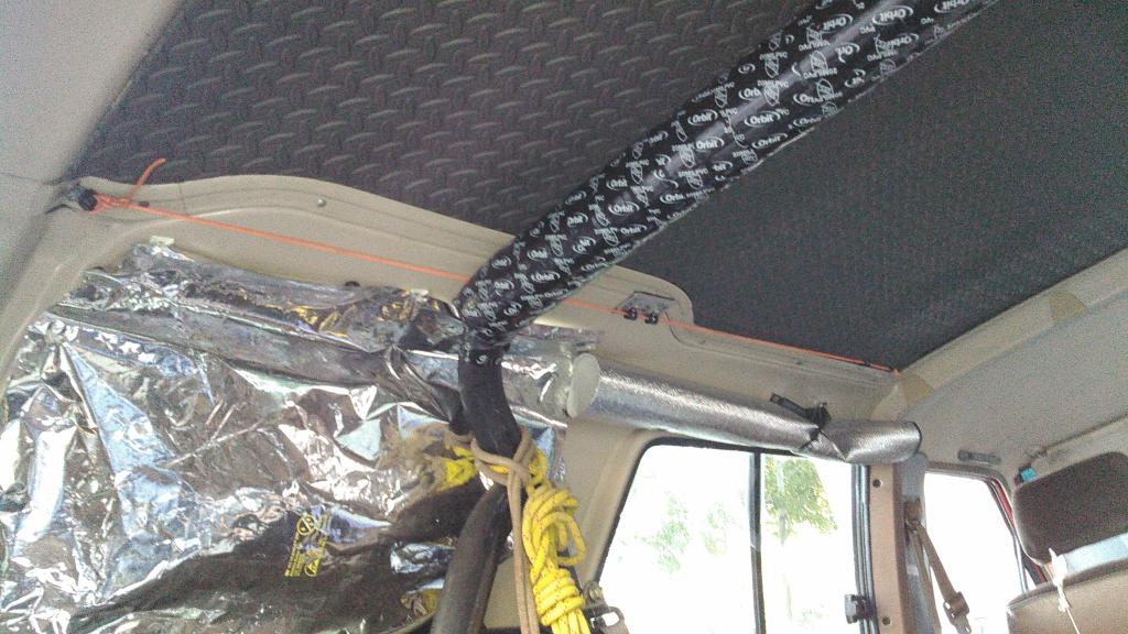

I used Diamond-Plate Pattern Anti-Fatigue Mat
... tears in my top's headliner
From "Top's", I assume you have a first-gen...
... even with nothing at all? I don't really like the look of the headliner that it came with...
Below should address above :)

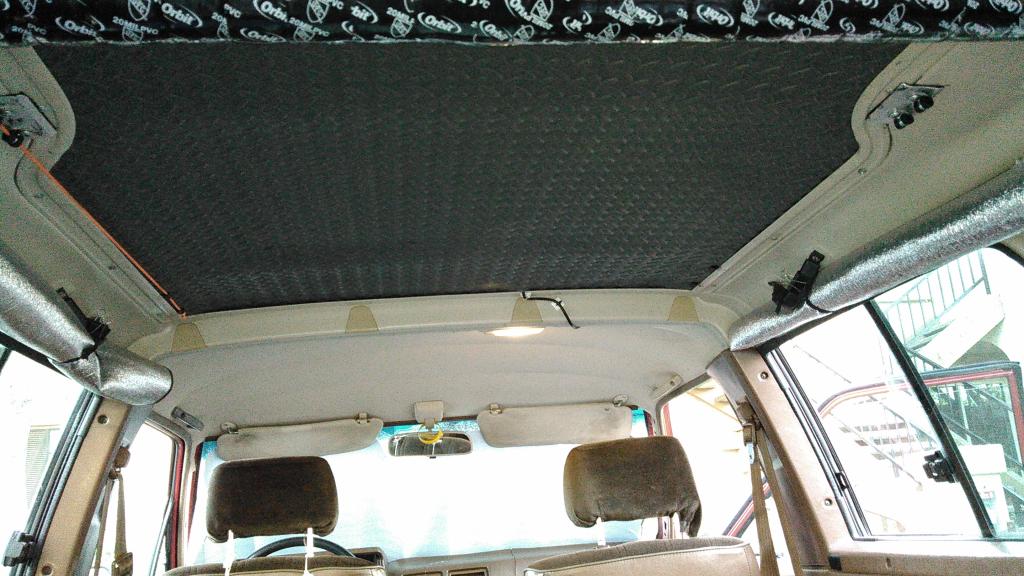

A few years ago, I used Diamond-Plate Pattern Anti-Fatigue Mat that I bought from Sears. big Lots also carried it back then.
Fits the utilitarian, simple, minimal, low-maintenance style of the first-gen.
Although used spray adhesive, I could have gotten away without because the material is stiff enough.

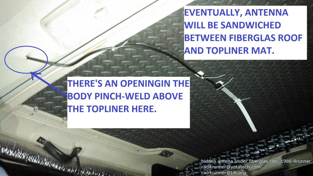

Pics also on my Rod Antenna Delete post:
https://www.toyota-4runner.org/1944195-post70.html
