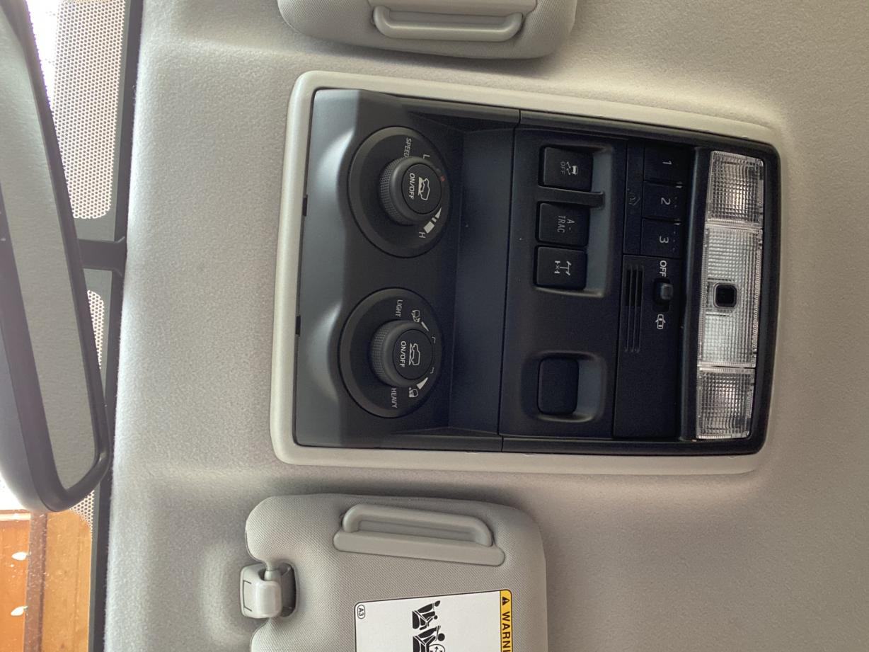

I have undertaken the project of installing sound deadening in my 2017 TRD Pro. I completed the entire back half of the truck last weekend, but was unable to get the headliner down. I had a 2010 FJ Cruiser and was able to remove it from that vehicle. The biggest challenge is the front top console. Do any of you know how to remove this without horking up the headliner?

Those 2 notches towards the front of the car. Use a plastoc pry tool and it pops down. Then theres some plugs and i think 2 bolts and the whole plastic piece can drop down. Not aure about the whole headliner. Ive only taken the console out

Thanks, KWSRStorm! I happened by a review of an Alpine stereo install and the guy happened to film the removal of that part. It looked to be just as you described.
I had the two bolts out, but was just scared to pull the full plastic piece out, not wanting to destroy the headliner.
