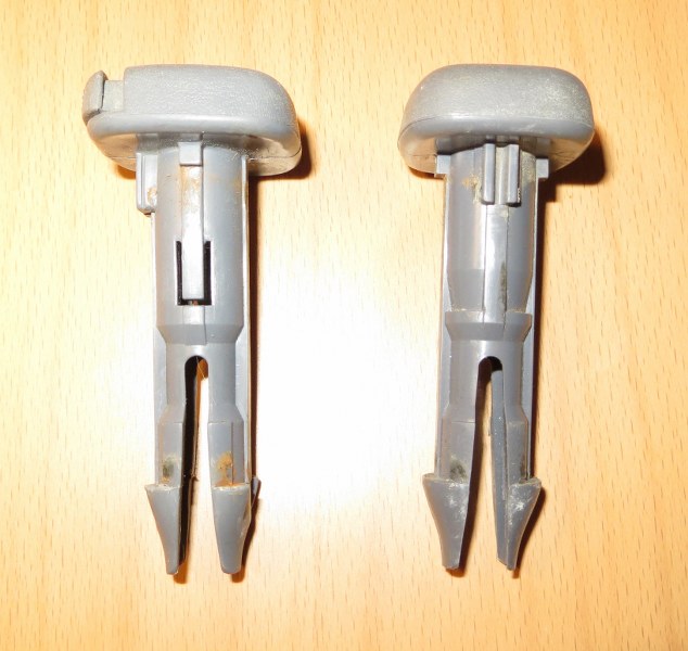

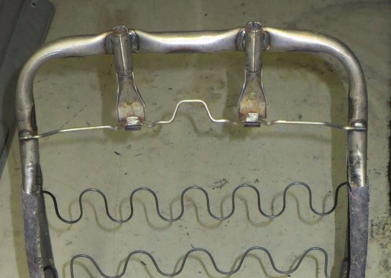

I'm not sure there is an easy way to yank these. The ears of the "clip" portion engage the end of the tube and are darn near 2" down below the surface. If you squeeze the end, they pop right out - but getting to them is not fun. You might try making a hook tool from a wire that you can fish down in there to try to release the ears. I was pulling my seat covers anyway (foam swap + passenger to driver side cover swap) and was able to reach them with the cover/foam partially removed.
Here's some pics:

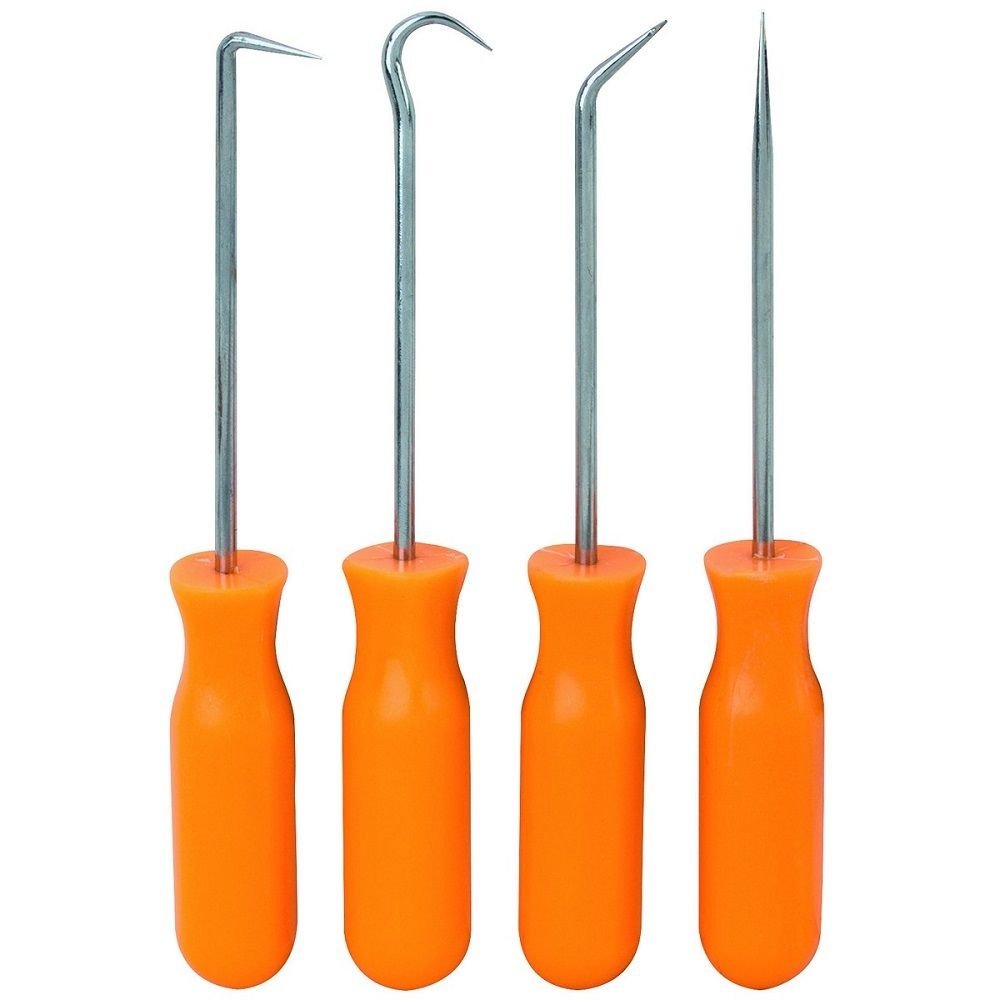

Plastic part, steel sleeve...drill it out. Although you might try a seal pick, first, and try and hook those latch points while levering up the collar with a mayo spreader. I'd use one like the one on the left. $6 the set on Amazon. Come in handy ALL the time.
Here's some pics:

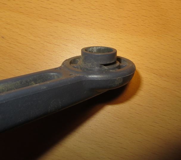

Another challenge: How do you remove the lumbar support lever on the driver's seat?
This one is much easier than the headrest clips. There is a metal retaining ring that needs to be removed, and then the lumbar lever will slide off the shaft. You can barely make out the retaining ring in the first pic. Second pic shows the groove in the lever that the retaining ring engages.
Here's some pics:
thanks for the pic! After reading your note and seeing how they were positioned I was able to reach them with two fingers, squeeze and yank! (that didnt sound right lol) Didnt have to remove the foam. Im also doing a replacement of the leather.

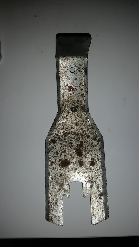

The retainer clip that holds the lumbar lever in place is a b*tch. By fluke my buddy had a tool exactly for the job!

I have the new replacement clip but haven’t attempted to replace it yet but when I do that is exactly what I plan on trying to do. Based on the picture of the seat back frame assembly provided by another member earlier in this thread that looks like the way to go......just push the remaining broken piece downward and insert new clip.
