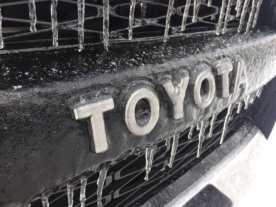

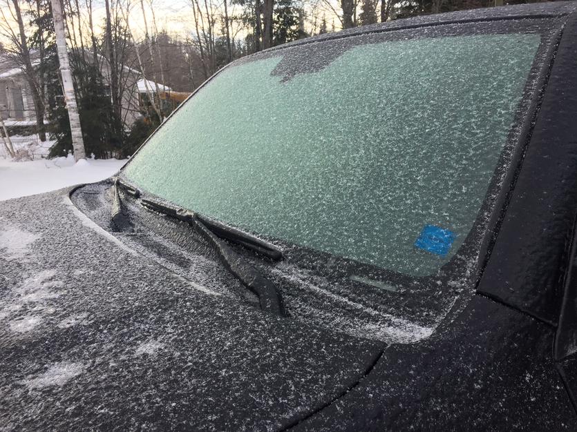

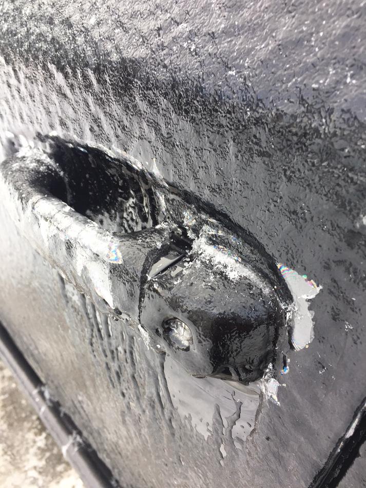

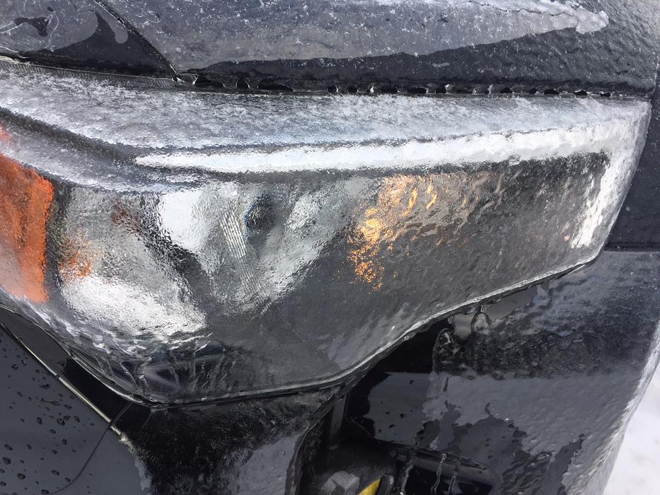

but often I see people that are adamant that 2 minutes is too much....
some times the conditions call for the amount of time.
