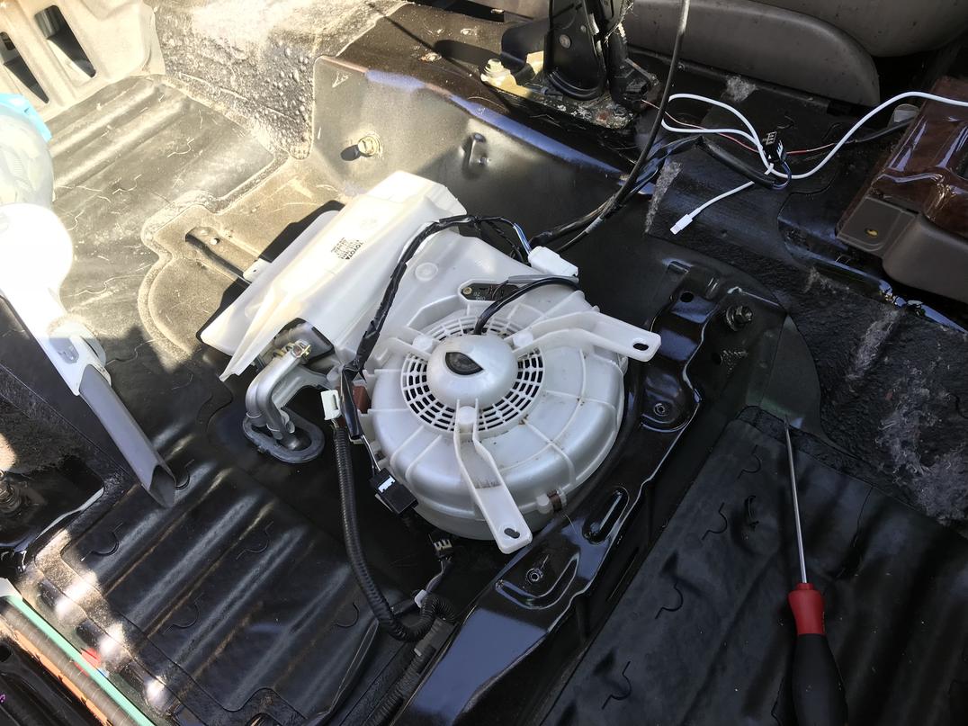

I’m pretty sure there are write ups on how to disassemble the heater control under the passenger seat... but I can’t find them...
Can anyone help me with a link to how to clean the fan here &/or a write up that guides you through this process????

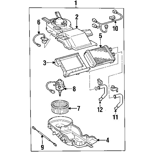

If you just want to clean, you can pull off the top cover without disrupting the heater core.
